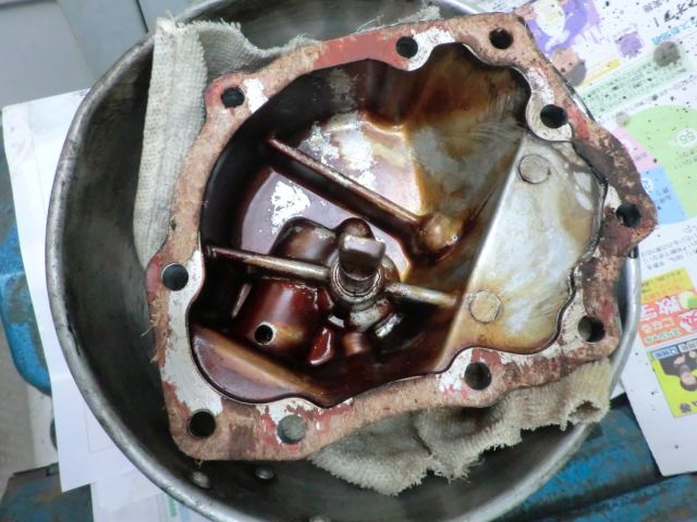

Hello to you good mini people
painfully edging along in my engine build,
I tend to be very wary of gaskets and like everyone without exception hate leaks
the gearbox speedo drive cover has a few bolts that are in pretty tight with blue threadlock and a very dry hard set gasket - so I suppose people do not want it to leak
if I can torque all the bolts down evenly that would help too
can't find the figure in the manual or on the site - I have looked honest
I am guessing it would be around 18 ft/lbs but that is just what the figure is for the diff housing cover
any help very much appreciated - all these little details count for so much and I want to do my darnest best to not have a leaky box or engine for that matter
a very big thank you if you can help me out here

Your intuition is correct. 25Nm or 18 ft.lbs is the figure. For you info the 2 small cover plate bolts and speedo drive clamping plate bolt are both 8Nm or about 6 ft.lbs.
