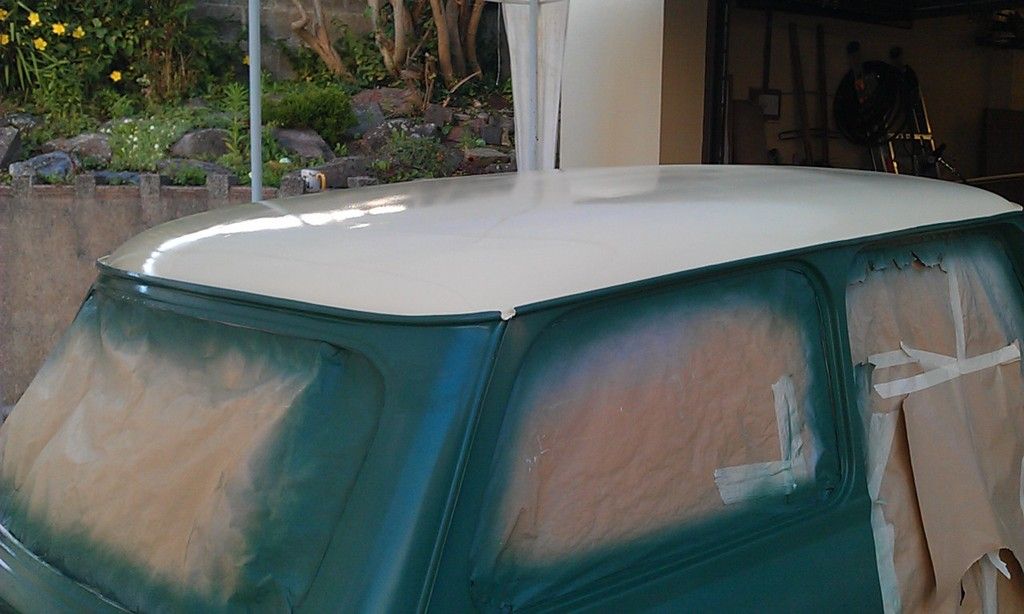

I have just finished the roof, 7 coats wet on wet.
