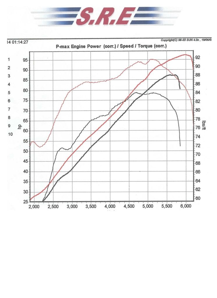

Posted 20 July 2016 - 10:17 PM
Here you go,544 cant match that torque at 2k rpm!!

Posted 21 July 2016 - 08:18 AM
4E600B36-3D74-401C-A5B4-9D281F967845_zps
AC Dodd RS Cam in the red, 248 degrees duration compared with the 270 of the other cam

Posted 21 July 2016 - 11:26 AM
Now is it a 544 or a 276?
