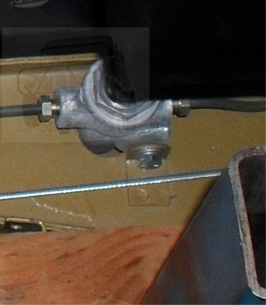

The bracket etc needed looks to be there. Presently, I see from your first photo, there's a Tee piece fitted where the valve should be. Remove the Tee and the Valve should go in it's place. These should be a hole, about 1" in dia for part of the valve body to go through.

I can't quite see from your photo, it's a little dark, but I think the bracket is there. The Tee piece is bolted up to it.
If some numby has cut it off, easy enough to fabricate one.

Here's a clip from a photo
you can see the bracket under the valve

Oops did not notice that is was a T piece in the first photo. Thought it was the regulator as that is where it should be.
