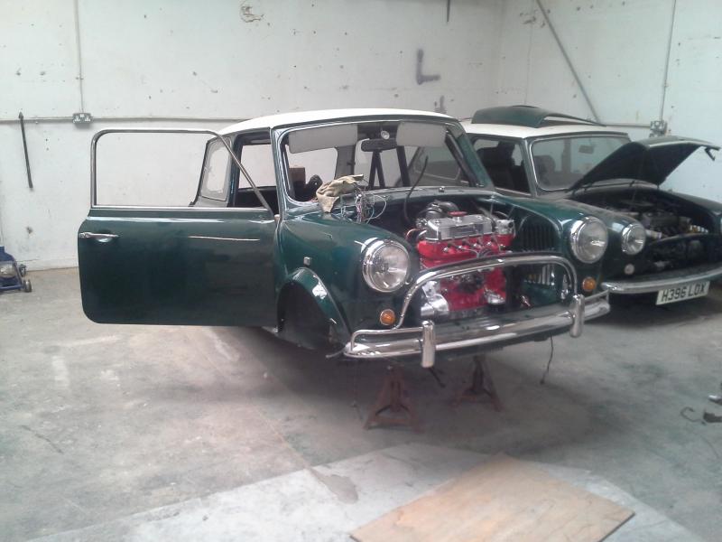

Hi all,
I have recently had my metro engine rebuilt, after fitting it back into the car it will only run on tick over and cuts our when throttled up to around 4000rpm
It was working before with the same setup last year but started burning oil so went for a full rebuilt at a local specialist.
It is a standard spec engine, with an induction pipe and k&n filter, facet square fuel pump, fuel filter and pressure reg.
Things checked or tested
Fuel pressure 3psi on tick over rising to 6psi ish at 3000psi
Gasket to carb plenum
Fuel pipe connections
Balance pipe blocked off
Timing ok
The engine builder has a rolling road and offered to se it up for me, it won't boost up. When they throttle it up either on or off the rollers the fuel mixture leans off and the engine cuts out as if it it running out of fuel.
Fuel mixture is ok on tick over, it has a standard needle fitted.
I have spoken to SU today and they have suggested changing the needle to one the will run a little richer up the rev range. We have tried all the obvious things and running out of ideas.
Any help would be great
Pete
