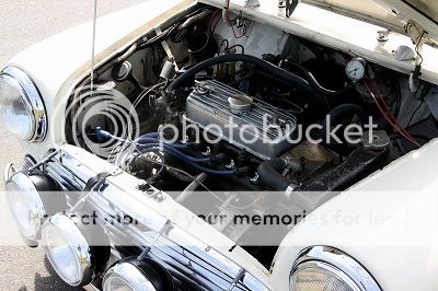

I went with the minisport bar as it looked the same as this:p84578n1_zpsrspg4n66.jpg
The other bars on the market appeared to be different in that the middle mount is removable and not fixed as the one above. (minisport sold both styles).
I know works isn't a standard or a specific size, it as a mere umbrella marking term for a style of bar.
Anyway, I think the bar I have will work with the lamps i have.
