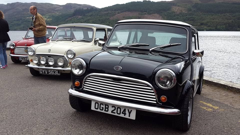

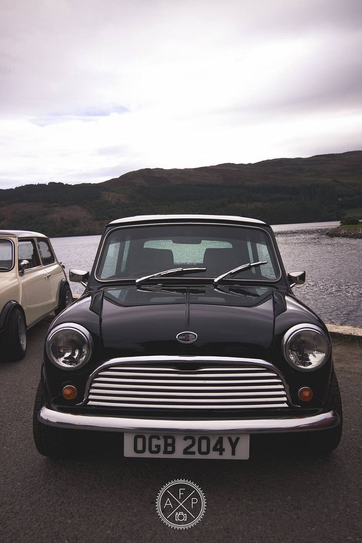

The car is Solid as it was rebuild in 2006 and resprayed it then only covered 700 miles till now.
I'm planning/ in the process of building the mini up to a "period" track spec car.
The current spec is ....
1380 morspeed race stage 4 engine
Morspeed big valve head (stage 4)
Morspeed Ph Rally Cam ( like 286)
Lightened flywheel & updated clutch
Full roller rockers 1.5:1
123 DIZZY with selectable advance curves
45 Weber on long manifold
Electric fuel pump
Rebuilt gearbox
Maniflow stage 2 manifold
2" single box exhaust
2 core radiator
Solid subframe mounts
Updated front cones (springs)
Hi-lo adjustable suspension
Fully adjustable tierods/camber brackets
Interior is pretty much standard apart from,
Metro Gti seats
Luke 3 point harnesses
Rear roll cage
Later wooden black dash
Rear seat,door cards trimmed in black alcantara
