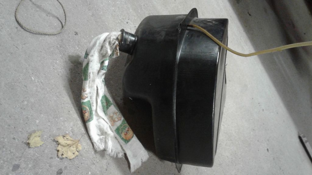

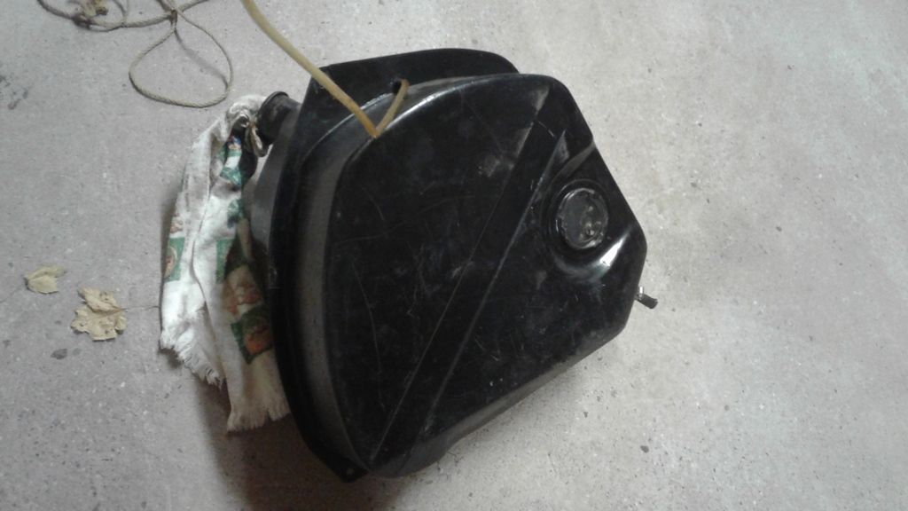

Like the title says, I don't know what my fuel tank size is. There is a diagonal indentation on the side, does it mean it's a 7.5 gallons?

That's a 5.5 gallon tank. The diagonal indent is where the tank strap sits.

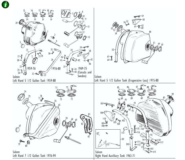

Are you sure? Somerford seem to show the indent for the 7.5 gallons, but the 5.5 gallons have vertical straps?
http://www.somerford...age=page&id=161

Weird, looks like a 5.5 shape but with the 7.5 strap channel.

I'm fairly certain looking at the size and shape of it as i have a 5.5 gallon tank in my '78 saloon. Though as Mini 360 said it seems to have the indent as per a 7.5 gallon tank. 5.5 gallon tank have more angular edges compared to the 7.5.

I now see that a real 7.5 gallons has a bigger belly, so it must be a 5.5, with a diagonal strap indent, but with a vertical strap was used. I think I'm just going to buy the diagonal 7.5 gallons strap and shorten it as needed, does it make sense?

Part number 29 in the Somerford image is the diagonal strap for a 5.5 gallon tank, fitted from 76-80 (generally in the smaller engined cars). Despite what the picture shows, those tanks would have an indent.
Shortening a 7.5 gallon strap is quite straight forward.

You are so right! I overlooked the top left image just because the tank didn't have the indent. However the part is not available anymore. Maybe from another supplier.
