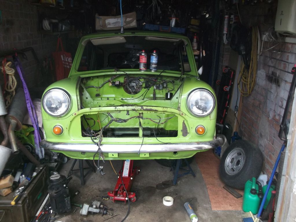

I'm sans job at the mo so temporarily have some time on my hands.....two weeks ago.... bulkhead cleaned up.....
Engine now fitted ...but have been away for a week or two - so nothing further until today.....
The plan....
There's no budget - I'll stump up for the required welding but apart from that there's nothing in the kitty....so no respray  - rattlecans will have to do for repairs the odd roundel may have to come into play too....just my time, effort, collected spares stash and whatever I can scrounge or trade....(fairly resourceful on that score!)

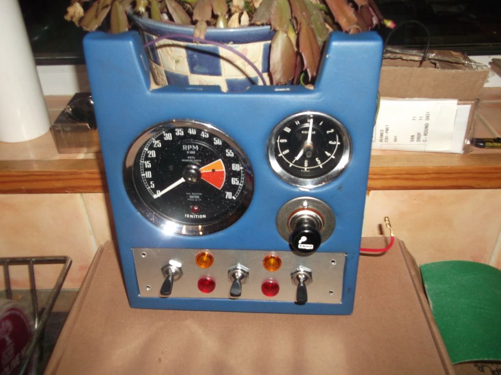

Interior - Equinox - literally everything that was in the spi bar the instruments - snot's original roof lining stays....  3 guage centre binnacle fitted, aux instruments - volts & vacuum on bracket, others in centre console... started remodelling that today as I've done my back in  - so light inside job needed....with some bits I had lying around.... so far... and yes it does fit by altering angle........

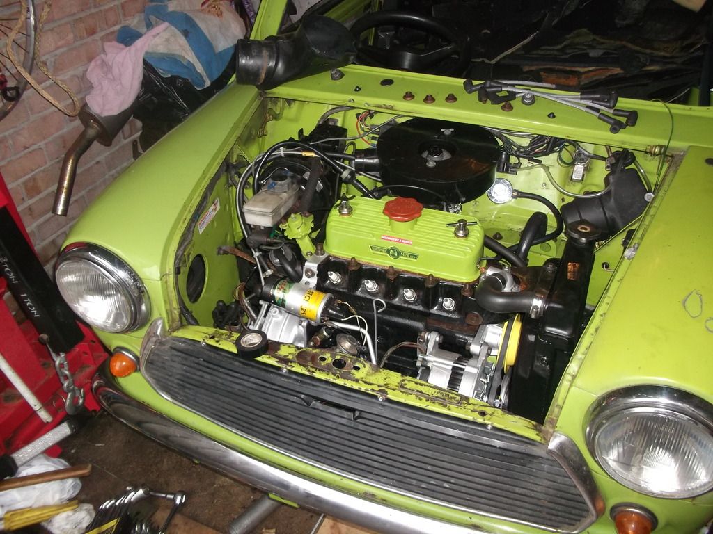

I'm posting as a project when really its a recommission / improve  in order to keep my enthusiasm going - a week and a bit on from pic already posted and....
.... thank god I used the spi subframe..... the airbox clearance is marginal at best!!! (have put a vac take off plate in)... all my teenager mods have been binned now.....
A bit uncomfortable at the mo but got underneath this morning , strapped up the inner CV boots, put in the gear linkage roll pin and put the Y piece on the LCB.... that was a sod! - a bit of storage rust meant it was a bit reluctant....
A couple of  fleabay special packages arrived  today -
- New heater matrix... as ever using the spi heater - the later matrix is thankfully cheaper (snots original was so crudded up the worlds supply  of flush / nxios chermical probably wouldn't have shifted it... the original spi one had some white furring so best replaced.....kind of job I like - all inside and 5 minutes flat! - a 15 quid jobbie so we'll see..... may be a case of getting what I paid for....
- Absolutely filthy Panasonic cd player, pioneer amp, Pioneer 6x9 speakers, wiring and custom consoles under seat speaker board..... all cleaned up  - mocked up in the house and all works! - result for a tenner :-).......a bit of reupholstery and jobs a good' un
- some nice brass hose reducers 5/8 to 1/2". swiftly popped out for some new 5/8 hose - the old spi hose too short for the retrofit
Best bit of the day - connected up the battery for the first time in a fair old while.....I've no oil pressure light  for some reason - so swiftly disconnected LT circuit, until I've investigated properly  but have both fuel & spark.......I've only one sidelight, one indicator doesn't work in hazards and the brake test switch doesn't light....  I suspect a few corroded connections!.......
