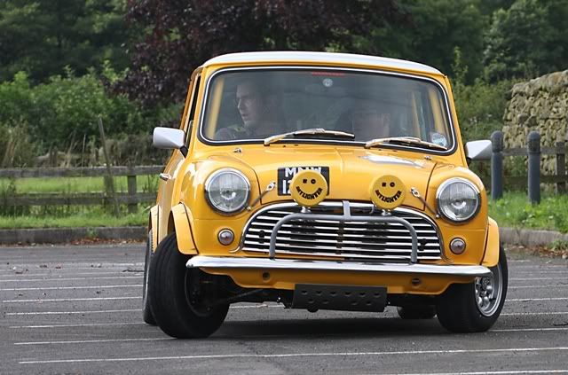

I always make my own bracket which can take 2 or 4 aux. lights depending on what event I am doing, I use Jubilee clips for top steadies which are easy to adjust:
Edited by Cooperman, 22 December 2016 - 11:38 PM.

I also made my own, but only for two lamps.
I leave the lamps attached and the whole lot removes with just 4 bolts (captive nuts).  Very sturdy, no steadies and no vibration.
