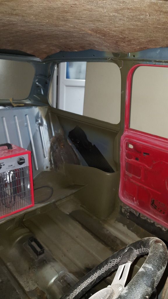

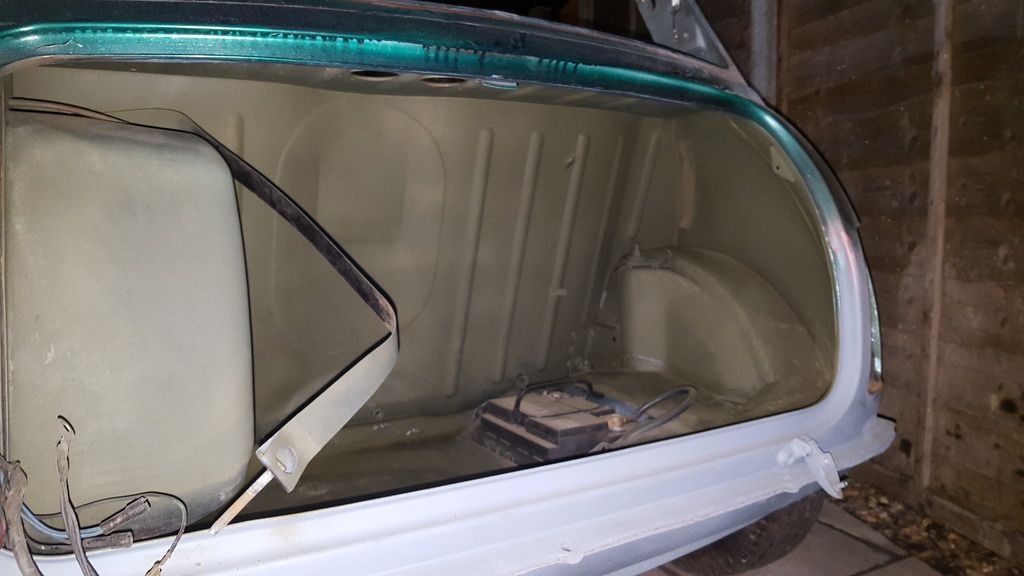

Tonight i prepped the inside then painted it the nato green matt.

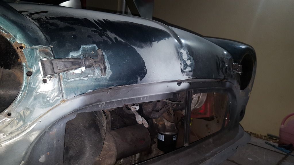

Tonight i removed the bonnet retaining clamps then drilled and fitted rubber t bars. I then removed them and welded all the previous holes from people before me lol. Also removed the washer jets blanks and wiper rack theb overhauled the wiper rack as it was jammed. Also watxhing a car program today called mob steel i seen this truck the finished its paint job as a patina look whata your thoughts on miffy looking the same/similar ???

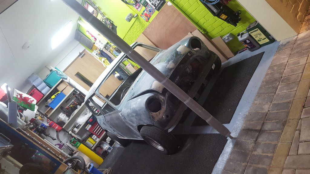

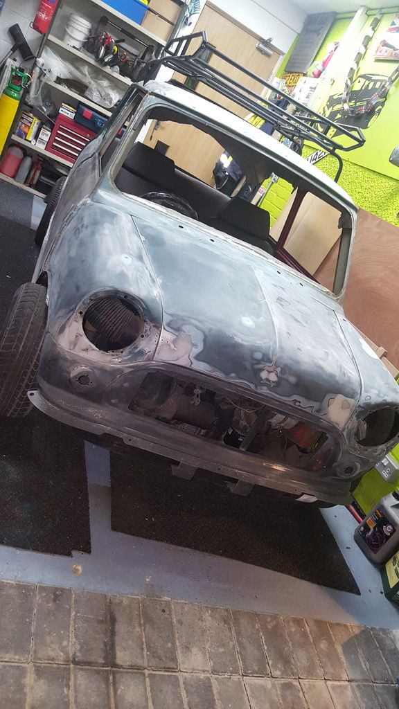

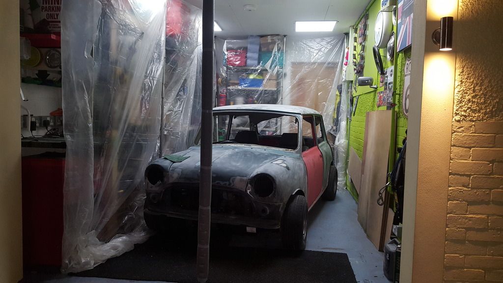

Miffyd snuck into the garage for now so i can sand come rain or shine. Just love the new compressor makes light work.20170314_223438.jpg20170314_211514.jpg

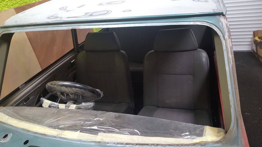

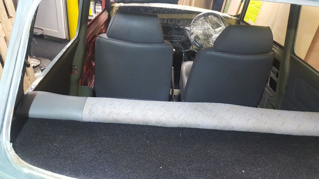

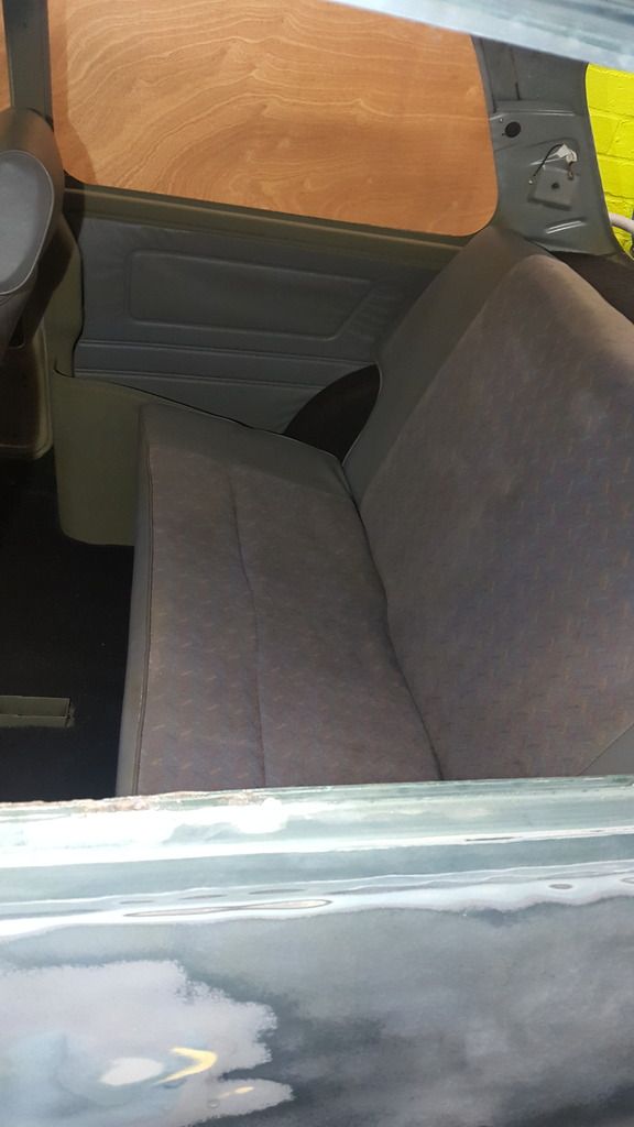

Tonight made good progress with most of the interior now in big thanks to (minidaves) for providing the seats door cards and boot. They look great installed against the nato green.

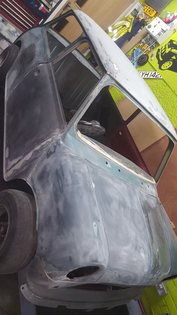

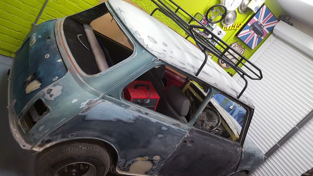

Tonight spent a few hours da ing again just some small patches of filler to attend tomorrow then onto tge hoover up a wash down and prep ready for primer:) hopefully in primer by the end of tomorrow theb blocked down tuesday evening and painted wednesday if all goes well by next weekend itll be getting re assembled :) ambitious i know but hey you gotta have a goal to work towards.

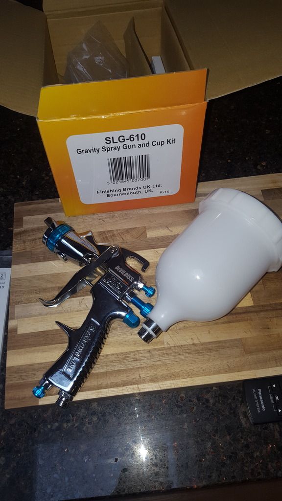

Well tonight i made a telescopic screen to keep most of the dust off then attended the small patches of filler then da'd the whole car again then hoovered all all the mess up. Then panel wiped it all down and masked it off ready for primer tomorrow as it was getting late. So a fresh hit on painting her tomorrow. Also my new gun for top coats.

I've just purchased that gun to so would be interested In what it performs like.

Havent used it yet as ive just used my old top fed gun with 1m5 tip for the hb primer came out well just need to flat it all back sort out a couple of small areas theb onto the top coat :).

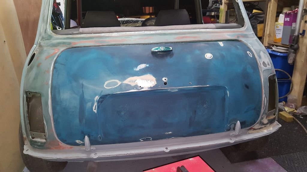

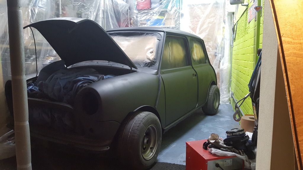

Thanks that what i though but will look evwn better in the nato green. :) as i have limited space when spraying pushed the car out last night and opened the doors fully back and painted the doors and frame by the hinges with nato green in a can just to help out when applying final finish.
20170322_205901.jpg looks shiny shiny as it was still wet the final product looks good once it dries back matt
