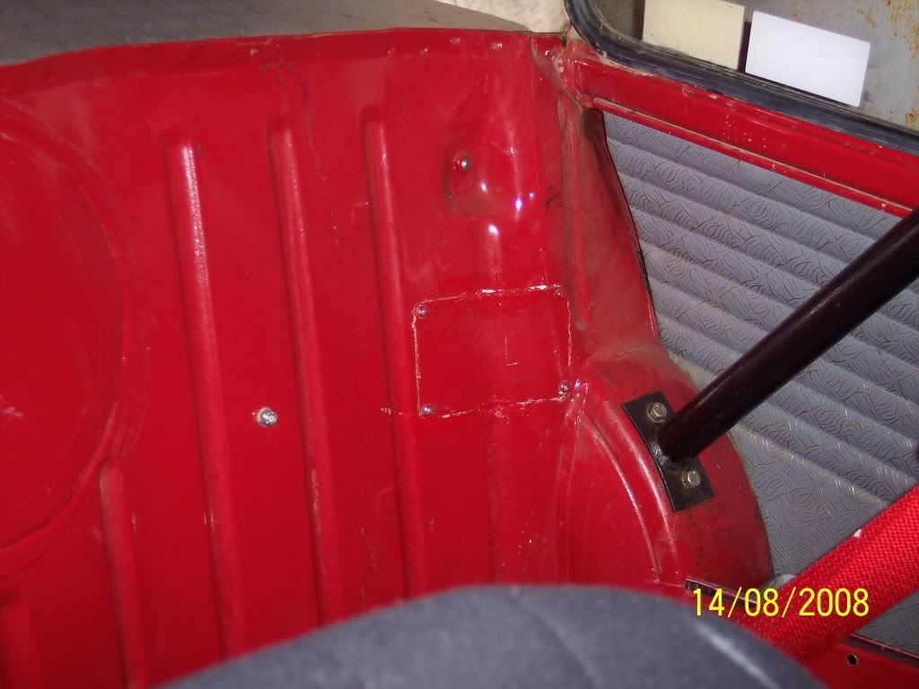

It's what we always do on rally cars so that the dampers can be changed quickly during events. Make sure you use some sealer when fitting the cover to prevent any fumes coming into the car from the boot area. Here is a photo of mine:

Cut a hole in the seat back and make up a closing plate to screw back to seal the hole using self-tapping screws.
Looks good. Any chance you could take some measurements of the position of  the opening for us to accurately locate & copy?  How close to the tank is that panel? Danger of tank holing while cutting the panel out? What's the best method for cutting, a hand saw or some kind of grinder etc?

For those interested, the hole is 4" wide x 3" high.
To cut it I drill at each corner and use an angle grinder with a 1 mm disc. The clearance to the tank is around a minimum of 1", so as long as you are careful there is no problem. The car in the photo has twin tanks, so there is a hole on each side. Two people can change a rear damper in 10 minutes.

I have done loads of these over the years and never had any issues. You can always drill lines of holes and use the cutter to 'join the dots'. That way the cutter does not intrude more than 1/2" into the boot. Make sure the boot lid is open, obviously.
