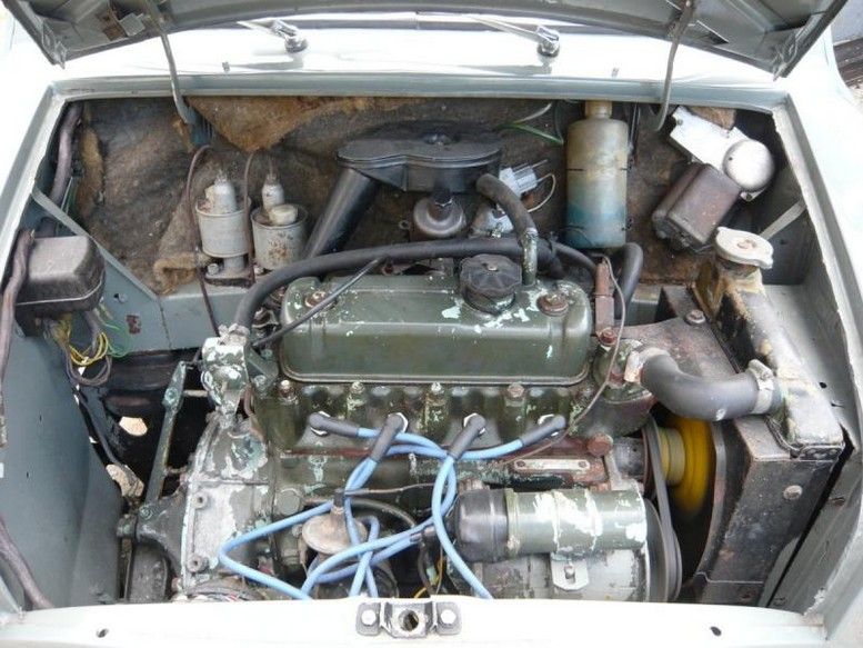

take a look at this. now this may not be important to you on a day to day basis but it shows the level of "progress" the mini went through.

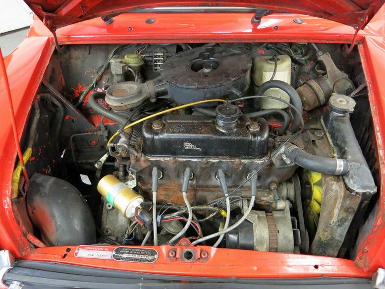

an old "early" mini engine...

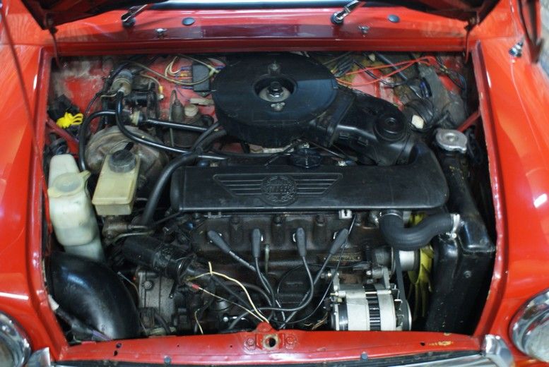

mid production 998 carb engine...

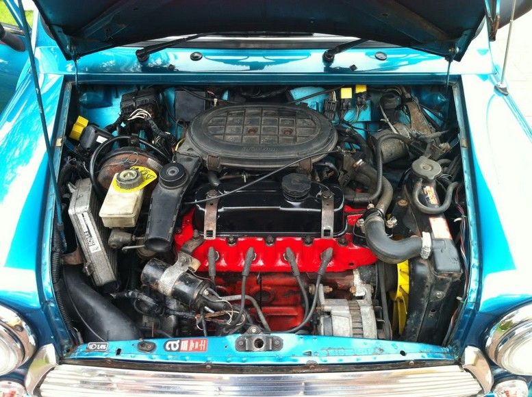

Cooper Carb engine with brake servo...

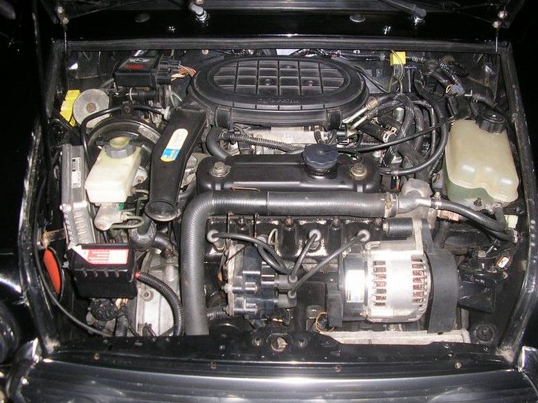

Spi or single point fuel injection engine. getting a bit crowded now. note the washer bottle has gone (moved to the boot)...
Mpi engine bay !!!!! :blink:  thats progress for you !!! all this is going to get in your way every time you do something...
