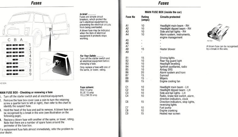

dip beams aren't  working but high beam and side lights are work i followed the wire for dip up to fuse box where there is no power on fuses 18/17 have no clue what to do next

A2 fuse C2 fuse

It can ONLY be the dip portion of the stalk switches or the wire from there, probably blue/red to the fuses (And any associated terminals etc), as you know that main beam works and if the fuses and bulb filaments are ok, there is nothing else, as all else is common to main and dip.
