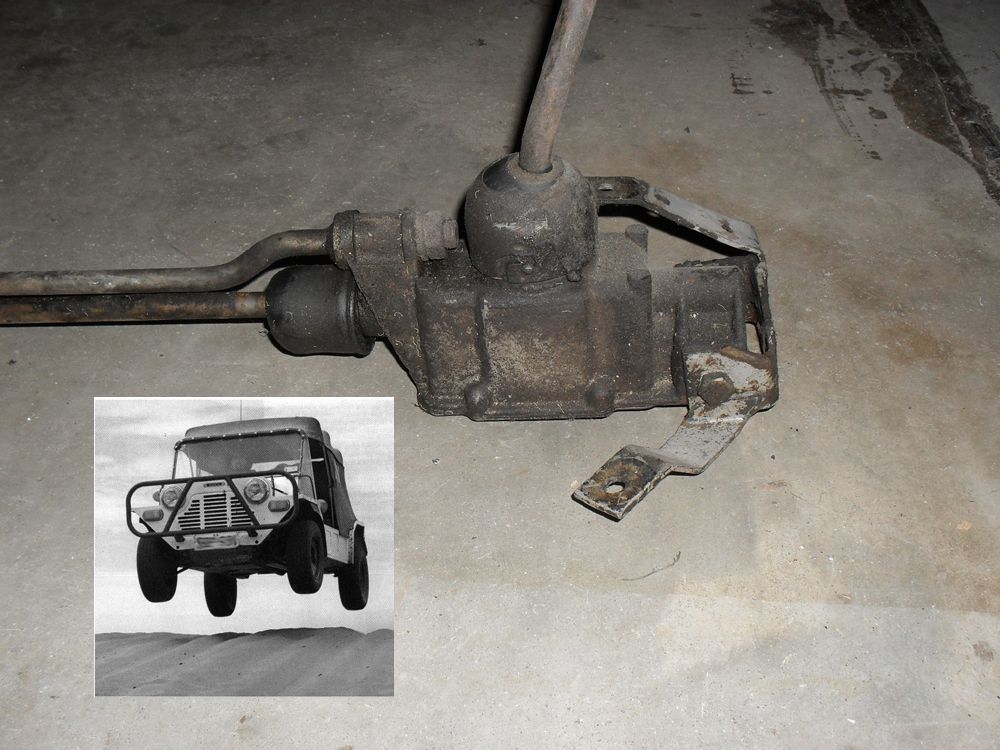

here is a photo of what I'm dealing with

They'd have been remote not rod gear linkages I think.

looks like an later make fit job.

It looks a bit of a bodge what you have there.
The Aust made Minis basically retained a MKI floor from 1963 through to end of production in 1978. The Rod Shift of course was fitted from 73 on and apart from a slight relocation of the hole in the floor and it's shape, the tunnel etc was the same.

Now I look again, I think you're originally had a Magic Wand!
Australian Rod Shifter Bracket
These had the shorter exhaust type cotton reel mounts to the tunnel and floor on the ears of the bracket.

I'm not sure about the differences with an Antipodean spec '71, but a UK spec '71 would have had the magic wand hole (with blanking plate as yours has) and would have been fitted with the remote gear lever setup.
I'd suggest that someone's done what I did to mine when I first had it and just fitted a later rod change setup due to them being much easier to find second hand.
