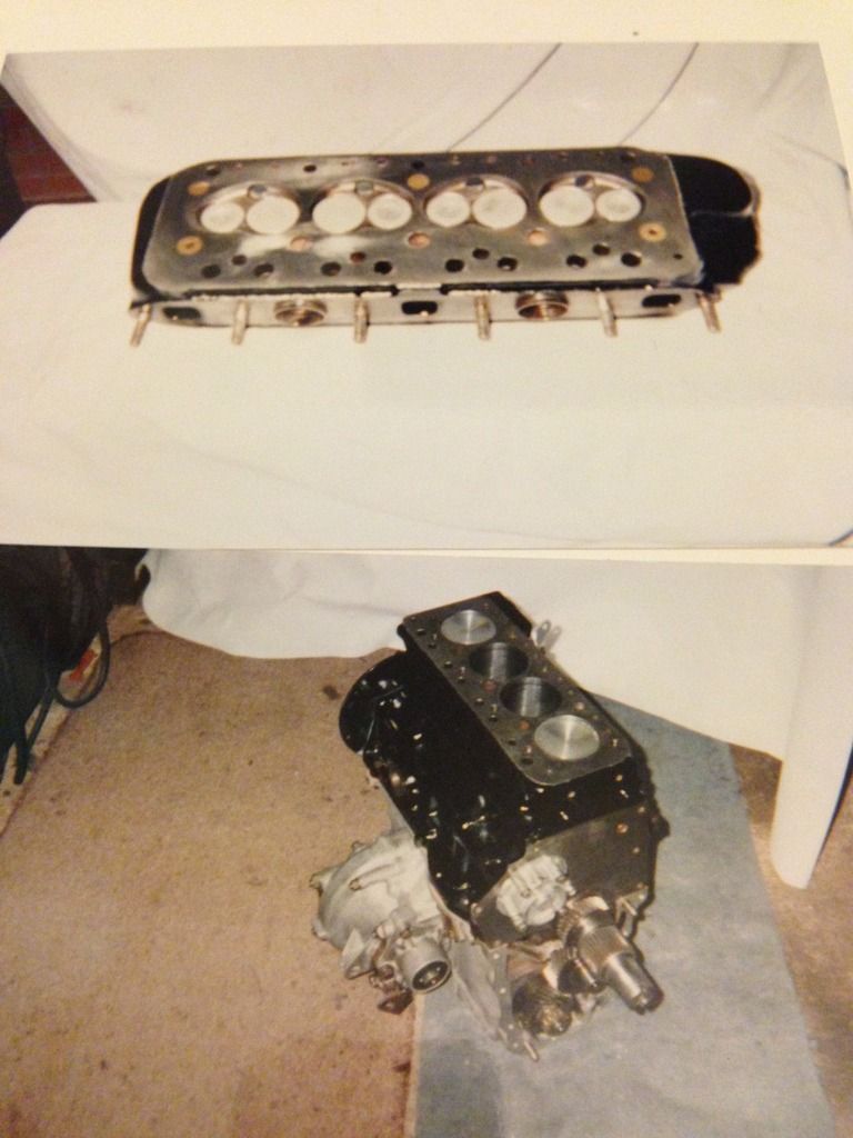

Got me thinking about an MG metro engine me and my dad rebuilt for my old mini. I bought it locally for £30! I had the crank reground and block rebored to 1293 and if my memory serves me right it ran a C.R 9.75:1 which I would imagine it would have run the same pistons as you have recommend. The engine had had a recon gearbox but it had a real low final drive but I managed to get a 3:1 final drive cheaply . I quite like that as the mini would sit at motorway speeds comfortably and it didn't accelerate too badly as I remember.
If I could build an engine like that is be very happy!
