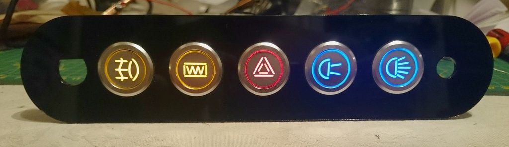

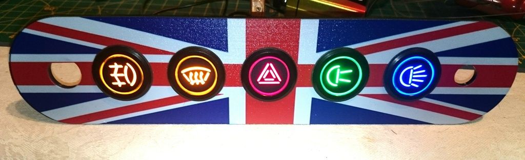

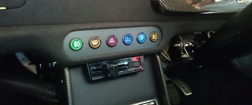

and dont forget these
http://www.theminifo...lay-new-prices/
