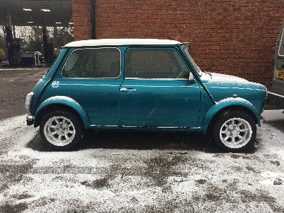

Looking good.  They drive so much nicer when they're not resting on the bump stops, don't you think?  :-)

Mine have been delivered today so I'll be riding high with you soon :-)

Looks great, nice colour.

I would love to agree....... But ive only driven him once.
I haven't driven a classic properly since 2009, and that one was a bit of wreck. Great fun to drive though  :D

Get some miles under her belt! (when the roads aren't salty!)

Thats an amazing picture. Shows just how much they compress over time. I think my current fronts look about the same as yours do.
To put it in  perspective - here is the car with the old cones, then with a new one fitted today

Those will settle in well. You need to give them some work to do !!
