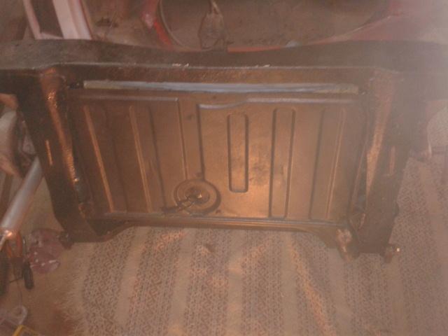

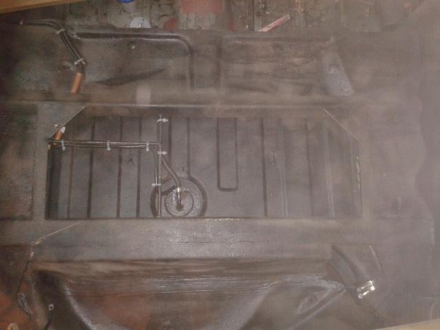

I don't think a fuel tank in the passenger cell is legal any more ?
I fitted a Imp fuel tank in the subframe & have a flat boot floor - it's a lot of work routing the filler pipe & vents , so on a normal car I wouldn't bother
also I don't think it is any bigger - but it made my project easier
also the spare wheel takes up more room - but a lot of cars have no spare anyway (anyone know of a modern space saver that fits a mini (12") ???
stick with twin tanks - when you save your pennies
I think Sir Issigonis would have approved of the use of space with the tank in the subframe.  I wonder why he didn't do that - I suppose it means finding a new place for the battery and as you say the spare wheel takes up more room.  Still it looks very neat.
