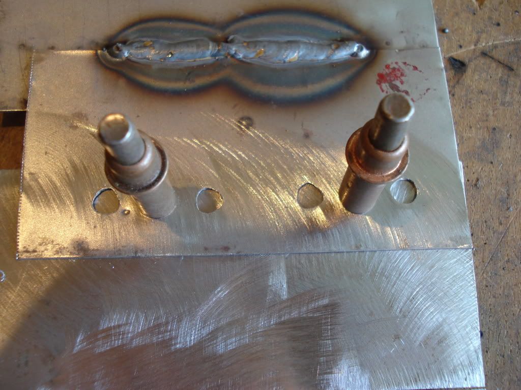

Nope is the answer here. You can weld it all on the boot side if so desired. It just means with the rear valance close out plates you will need to drill through the boot floor to the closeout panel then plug weld.
So fit the boot floor, trial fit everything else then either skin pin in place or clamp and then weld away. No need to weld it all together before hand. this will create its own set of unique issues if you miss clamp something.

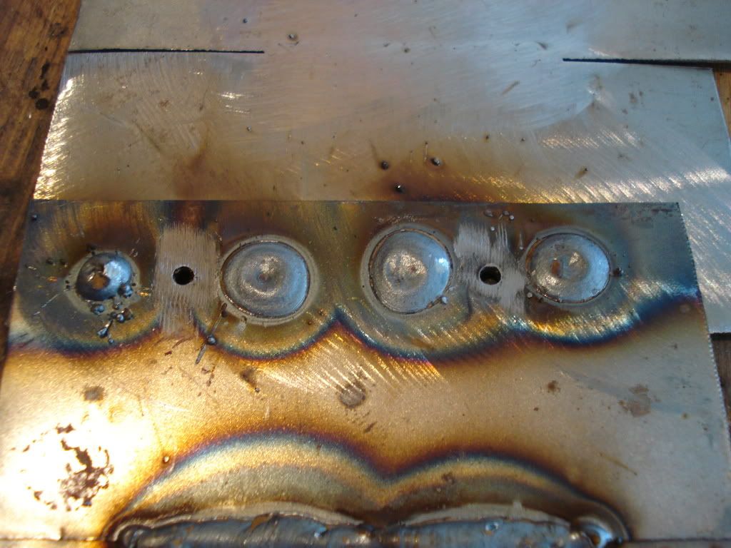

What size holes are you drilling?? Anything seriously structural like the close out panels I would be drilling 1/4” holes, I do not go any smaller than 3/16th anyway. That is normally dependant on the width of the flange. On my 135TE I up the wire speed to 8.5 and full power.

I would have drilled either 5 or 6mm holes and if memory serves the amperage of the welder (Oxford migmaker) had to be as high as possible without tripping the electrics.
Neil, why don't you blow holes in the metal at that power ???
Pete, the multiple layers of metal there quite happily take that sort of power. All of my plugs are the same, dont forget its only one hole in the flange you are welding to and blank metal behind.
Never have an issue with blowing through.

Posted 13 November 2018 - 04:21 PM
1ba2af317036fe8ef87c1efc22d92627dfbcbdc7
355fce7859a83bc610b9f41e5abcb97006219fa7
And as i mentioned, the hole on the left was low power with poor weld characteristics.
