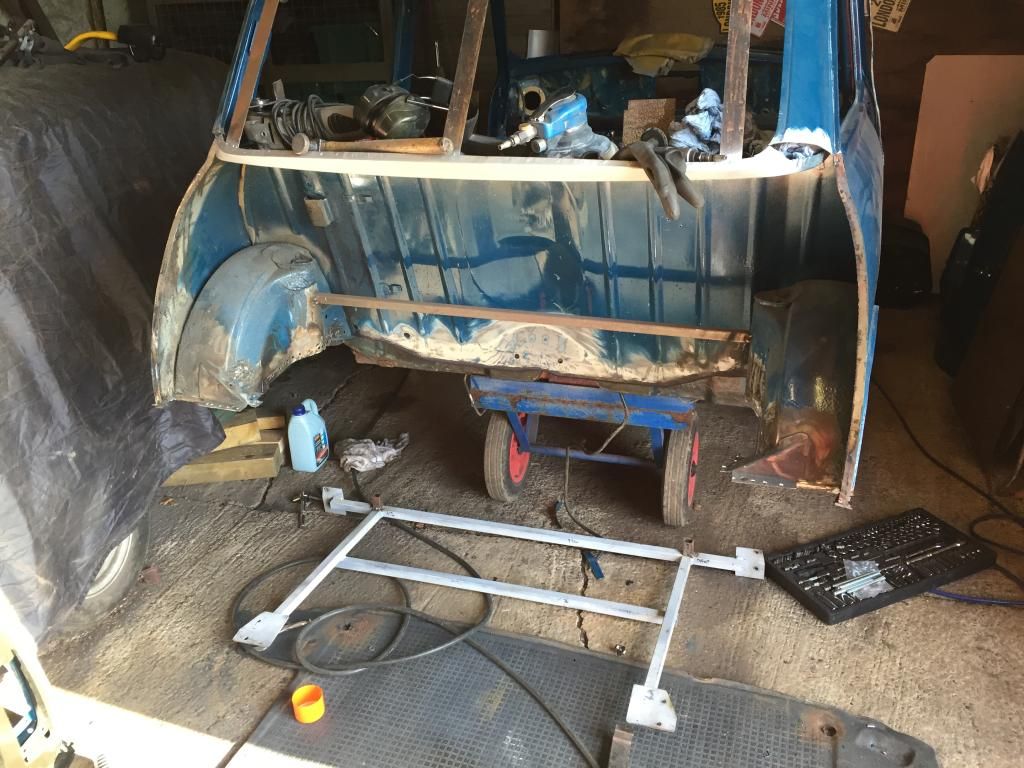

Subframe would be ideal but for ease and lightness make a jig.
I made mine from 20mm box and 2mm plate. You will need to gusset it or add another cross section as i did other wise you could end up with problems.

R right I see so the extra cross bar in the middle is just so it doesn’t twist I’m assuming as you say ma give problems, what’s the 2 small uprights (the unpainted bits) do they go to the boot floor ?
Thanks mate
Thanks mate
Those two small uprights touch the floor when its in place. Just another thing to help position things.
