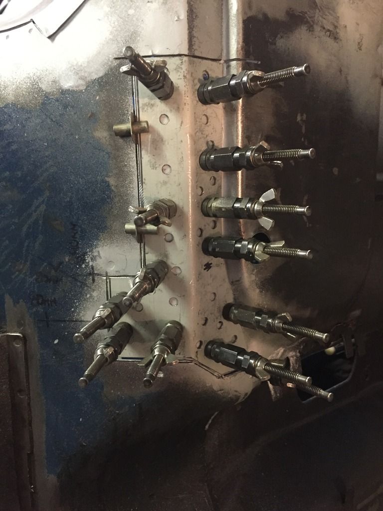

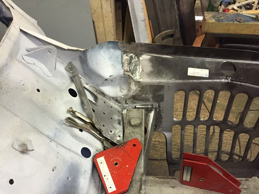

Posted 29 December 2018 - 03:31 PM
This is the old one out and you can see there were nine spot welds
0521abdeed9ef206a2c1bfe61a7e9393b6c08b64
451de621cbdec8214575493997177d9b1ef81cd4
8c92da1d7c314720d91f93f967ee70fa7c223793
Where the small return fits against the inner wing stiffener plate, that was plug welded from the other side of the inner wing. Sorry no pictures of that.

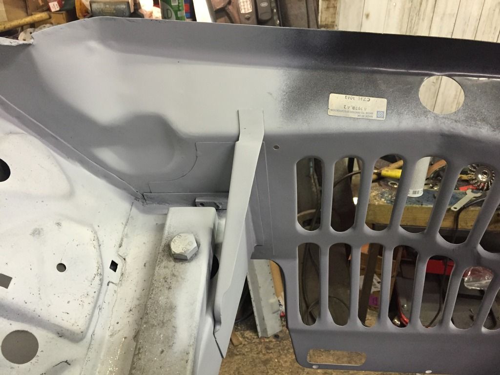

#6 sonikk4
sonikk4
    Twisted Paint Polisher!!!
  • 16,080 posts
  • Name: Neil
  • Location: Oxfordshire
Posted 29 December 2018 - 03:35 PM
And looking at the picture there were originally seven or eight small spot welds that attached the small return to the inner wing stiffener plate.
And these would have been the pins i used to attach the bracket to the crossmember
