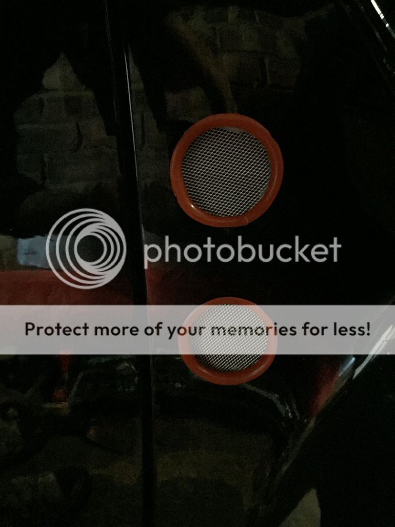

shame !  coul have done with one, anyway cut  a few into my A panels and to solve the lack of a swage, I solved the sharp edge problem by using 3mm i/d silicone vacuum hose cut to length and then split lengthways and then put round the 50mm cutouts. I then using clear frame sealant and some  fine repair mesh I got from Halfords meshed the holes over from the onside of the psnel.......sweet. I would post a picture but never can get the hang of posting pics on this forum using that photobuket app.
really bad photo sorry
