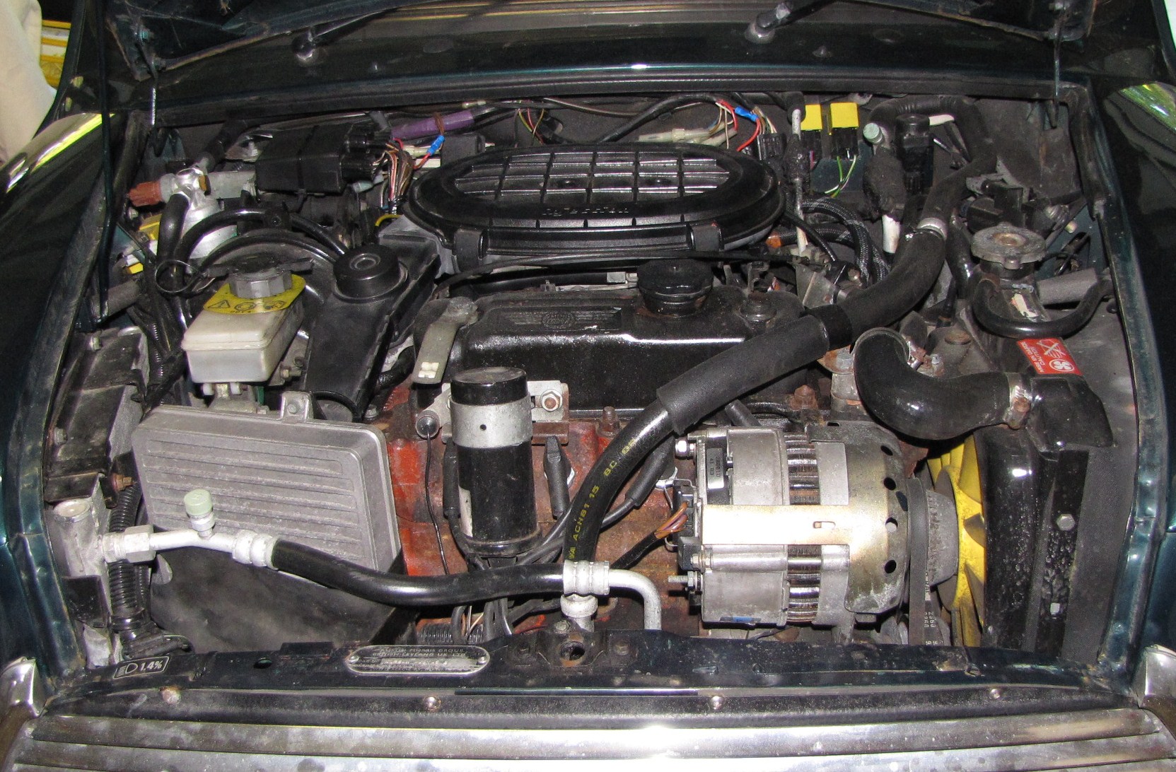

As far as I know yes. I always thought mine was just an MPI head and all the rest was SPI (inlet, rad, dizzy etc). It's a Cooper 35 LE for Japan.
For what you can see in amongst the rats-nest that is the engine bay, picture attached :)

Hi there, that picture reveals a pure JDM SPi, not the later MPi block based version but that should not affect the ability for the ACR to work with it via the three pin round connector.

It is just like my 94 Cooper, with the same snake pit.
ha! Only major difference is the fuse box type I don't have any in-line fuses and have the bigger 20+ box on the back of the bulkhead..
