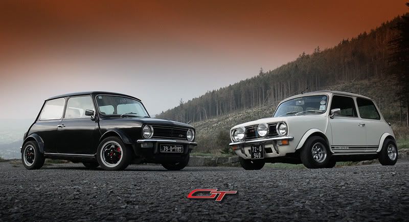

Right then guys, Got a wheel fetish going on at the mo!
on the black GT in the below picture he is running metro GTa wheels sprayed nicely in black with a polished lip, which i think look ace.
Wondered if anyone knew the sizes on the wheels width and diameter??
And also tyre sizes that could be used to fit under mini arches as im looking to get a set for my winter wheels to try and save the revolutions from getting manky.
prob 175/50/13 like all the other 13" rims?
or if they tyres that come on them standard would fit under the arches?
as those tyres are expensive just for winter wheels!!
Also i wondered if anyone had heard of ATS wheels and if the certain ATS Classics would fit a mini, they do them in 7x13 with a 100pcd apparently???

the metro wheels have a different pcd 94mm i think, only used with engine conversions normally.

Cant use 100mm PCD wheels on the mini,
you need 4" PCD.
Hasnt that black clubby got a Honda engine???
If it is the one im thinking of it probably is using the metro subframe.

i looked into getting the ats classics as mini93 says...the pcd may b 4 x 100 but the mini is 4 4" making the pcd too small...also tyres were really expensive

Yeah, sorry matey. Thats a K-Series under the bonnet so a different PCD !

i gather its a different PCD as the hubs at the front have to be replaced to match the running gear, but what about the back wheels??
same goes for Vtec conversions, what happens to the back drums are they changed to match the front?
#12 minimadjonesy
minimadjonesy
  • 6,417 posts
  • Local Club: SMAC
Posted 20 October 2006 - 08:36 AM
Most of them have Alloy spacers for the back wheels which have mini pcd to hold them to the hub and then any pcd to hold the wheels that the owner wishes!
