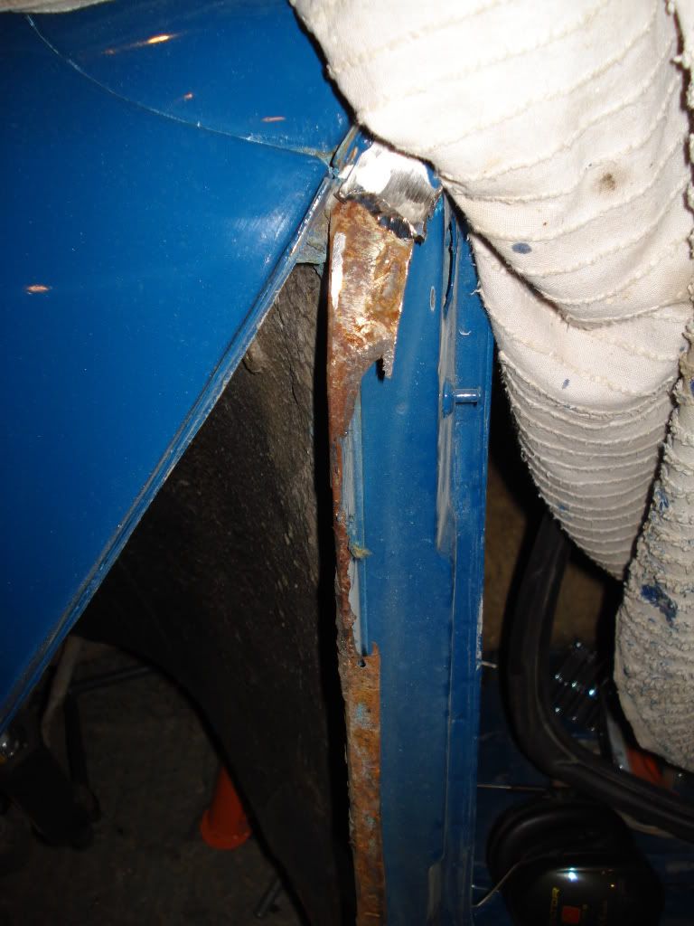

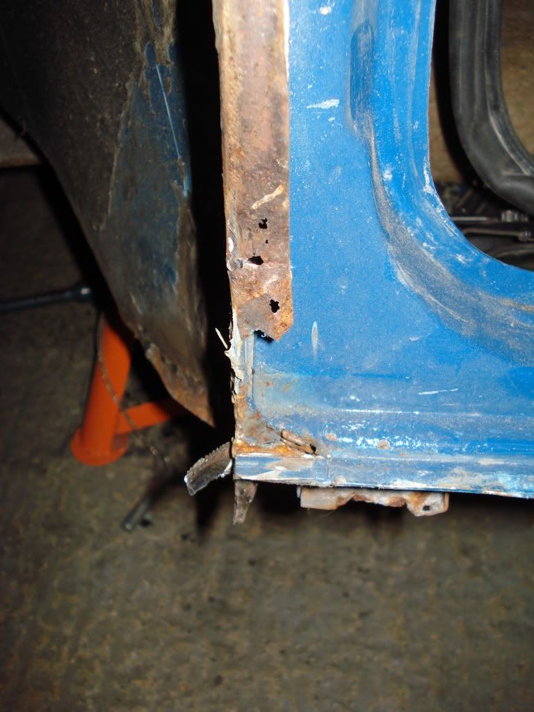

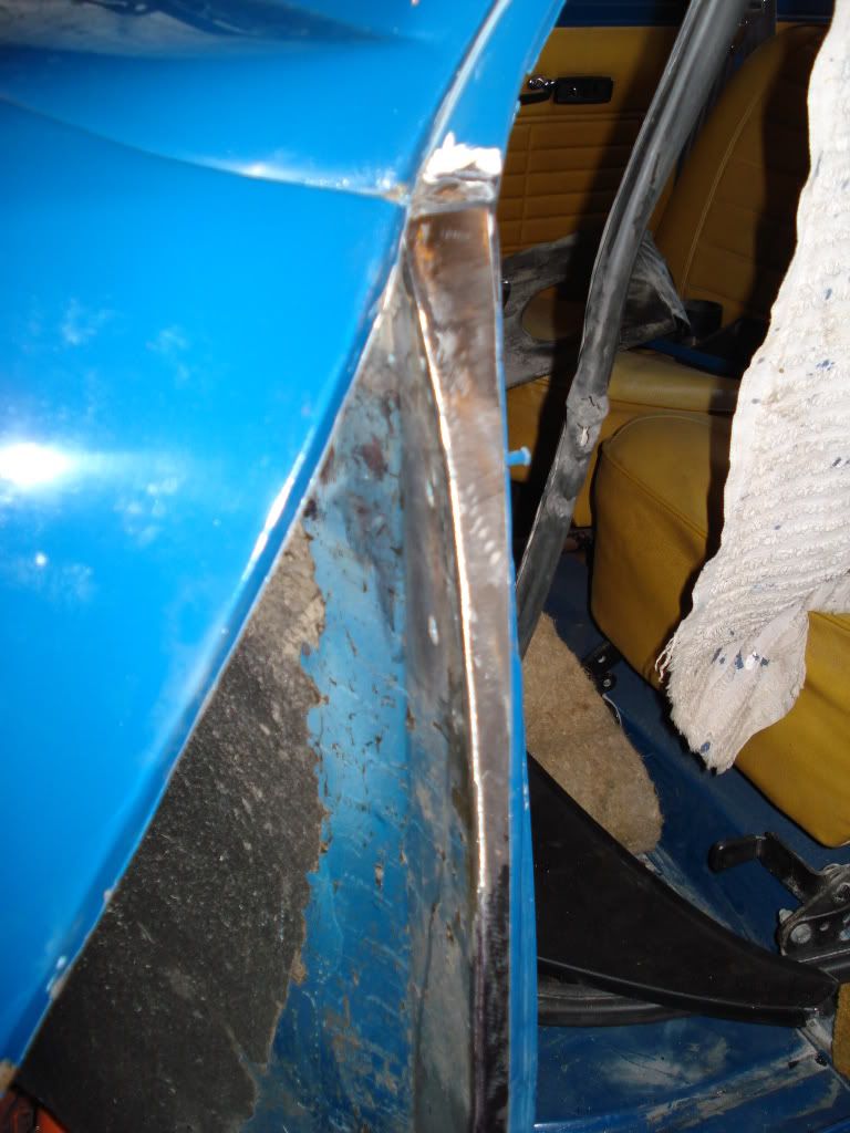

So this is a couple of pictures of the badly rotted A panel return on my clubby when we first acquired him.
fd97e2e81f002466f07154db88649309def4e2e7
5e15af53f21d1a91bf935aaa196ab78b4da6122e
And repaired
03b587b18c0c2ee241cf3046c4aa0215afa009b9
2d25555c5c2e1b13cb6c3949986acdf5c5f65684

Posted 23 May 2020 - 05:26 PM   Best Answer
Ahh now that is the door check panel
This one
https://www.minispar...|Back to search

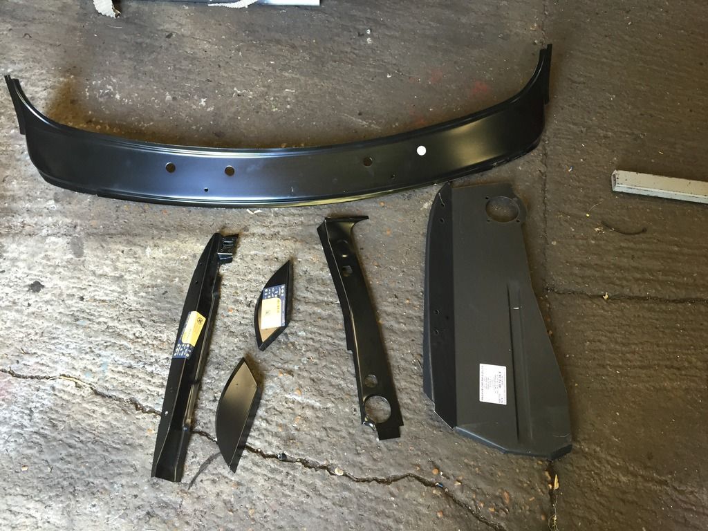

Something i did on Paddy
0f11cf4fddf4df9478550720dc745978cc98f7b1
and this is the page where it was all a bit dismantled shall we say
http://www.theminifo...rebuild/page-29
