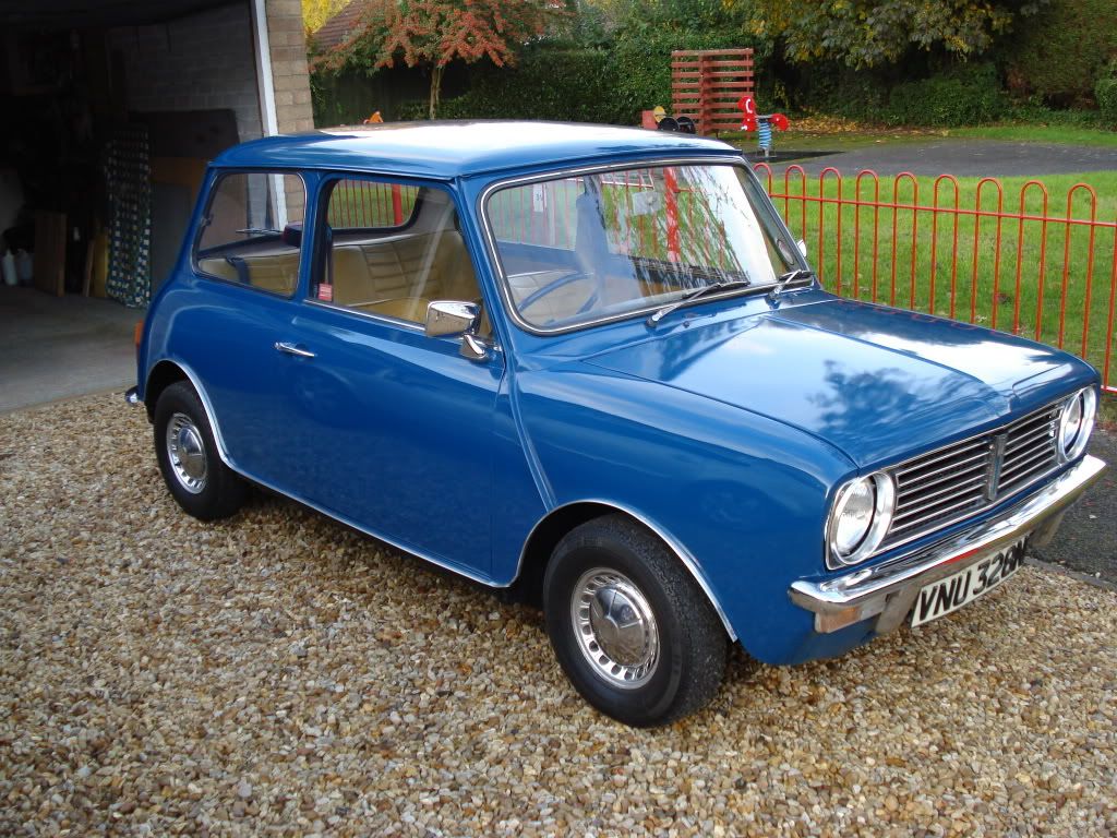

#8 unburntfuelinthemorning
  • 1,991 posts
  • Location: Cambridgeshire
Posted 15 July 2020 - 06:43 PM
81802ee0191672078c775b991cf76e97e256ee63
Now that looks nice.

#10 sonikk4
sonikk4
    Twisted Paint Polisher!!!
  • 16,091 posts
  • Name: Neil
  • Location: Oxfordshire
Posted 15 July 2020 - 07:19 PM
Looks were somewhat deceiving. Oversills and rear end damage which had been poorly repaired. Hence the full resto he's been through since.
BUT totally bog stock with less than 33K on the clock.

#12 sonikk4
sonikk4
  • 16,091 posts
  • Name: Neil
Posted 15 July 2020 - 07:34 PM
This is what he looked like before i restored him. In this picture he had been converted to Cooper S discs and Callipers, hidden behind Cooper S rims and yoko 165 tyres.  replacement A panels and proper short sills. Ran him like that for two years and other than a issue with a copper hg ran like a good un.
