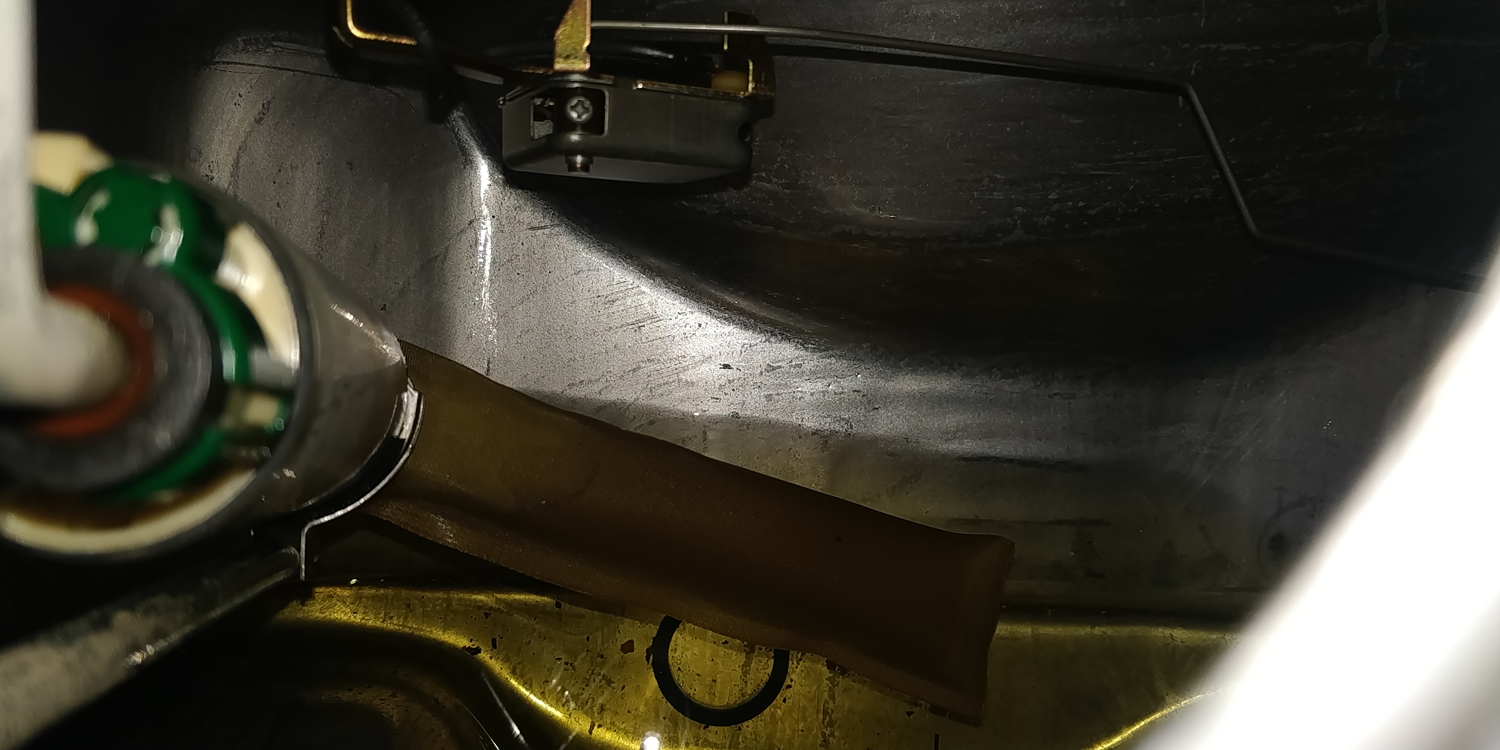

Got it all drained off this evening but no smoking gun, looks pretty pristine in the tank. There was however a loose rubber o-ring floating in the bottom which is never a great sign.
102117746-9beba580-3e36-11eb-80e6-d6a9ec
Any ideas what that might be off? Wasn't obviously missing from anywhere.

I found the same rubber o ring in my tank. No idea what it was for.

It goes on the center of the float for fuel sending unit.
