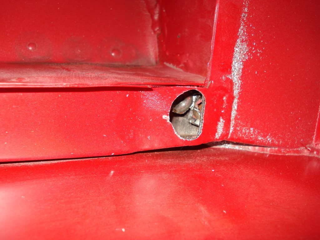

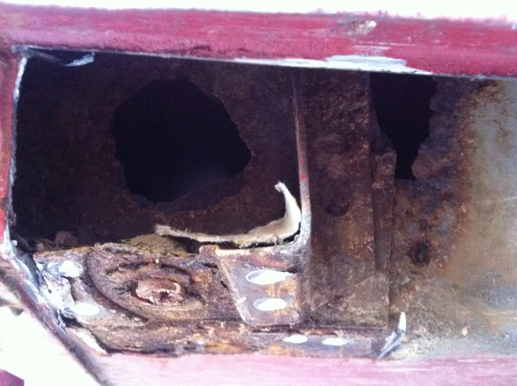

You have a couple of options. One is to do the access via the sill like this
c164c9b298260a2868a3bd4665f027ec02ca37de
But you may end up finding more than you bargain for. However at least going through the sill you can add extra weld to the other captive nut as well so its the lessor of two evils.d58a5b8fc7a08dc76d19e6b4b8f36c9a906eb12c

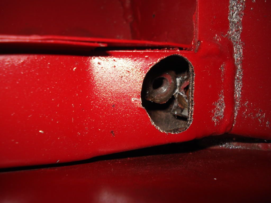

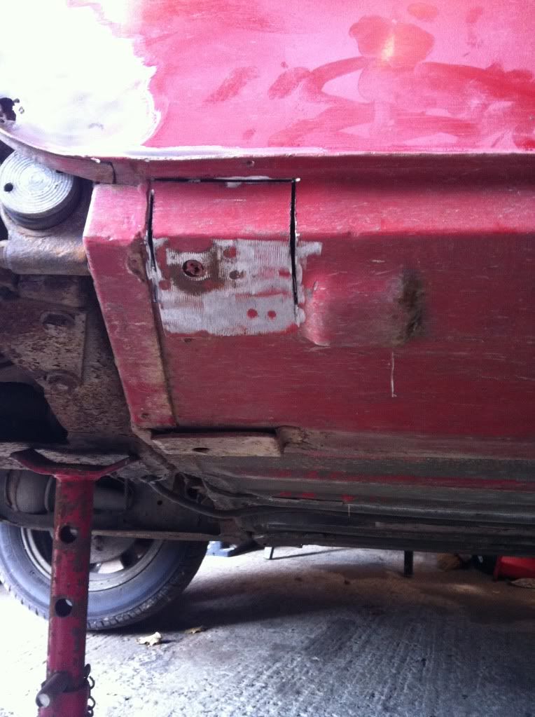

If its the upper one you can go down this route which we opted to do on my lads cars as we had just had him painted. Cut a large enough hole on the inner sill stiffener / companion bin closeout panel.
ba1162fa8a7e910589854d63e7b354ede376b2de
d2d9dd6a54d75df0cdb0c88c55c8240c8b6dee2d

Posted 15 December 2020 - 09:58 PM
I recently had to do as shown in the first photo.
That way you can ensure secure fitting of the nut, check the other nut and once welded back together and painted the job is done correctly.
