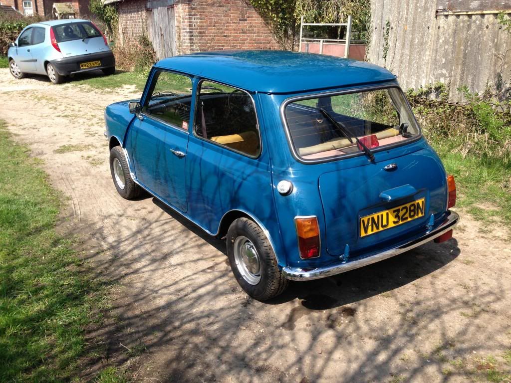

Before the resto I ran 4.5” Cooper S rims ( not reverse S ) with 165 tyres with no issues at all going through two MOTs.

Posted 19 December 2020 - 03:43 PM
42cda38c141d95112265f152495c93fb5657c769
