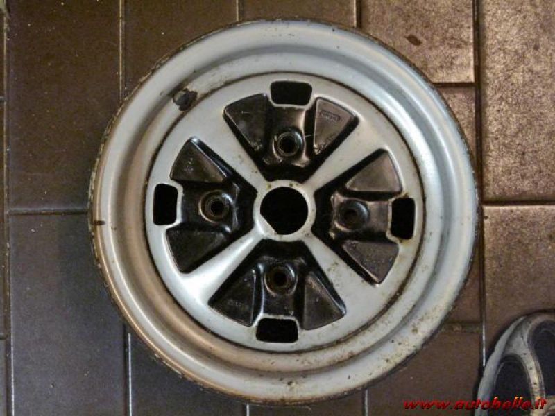

Authi used Rostyle wheels where Innocenti used Fergat/Firsat, they look similar but actually very different!
Rostyle
Firsat
