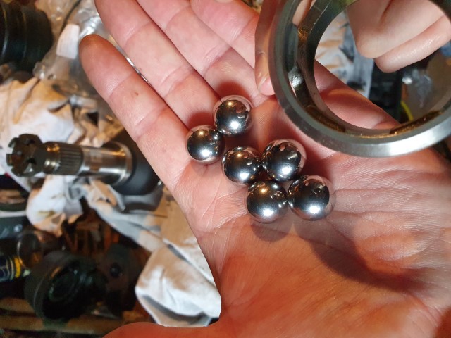

I removed the retaining ring and tried to pry off the bearing very carefully...but of course I broke it. A new bearing will be fitted, but I need to figure out how to get the outer liner out of the clutch housing.

I started to drive the mainshaft towards the clutch side of the gearbox to get clearance between the 1st gear and the mainshaft double row ball bearing. I drove the bearing carefully out and could assess the damage.
Gearbox motion shaft ball bearing cracked several places (Small).jpg 101.65K
0 downloads
Luckily I have a scavange gearbox that I can use and the mainshaft double row bearing is good.
