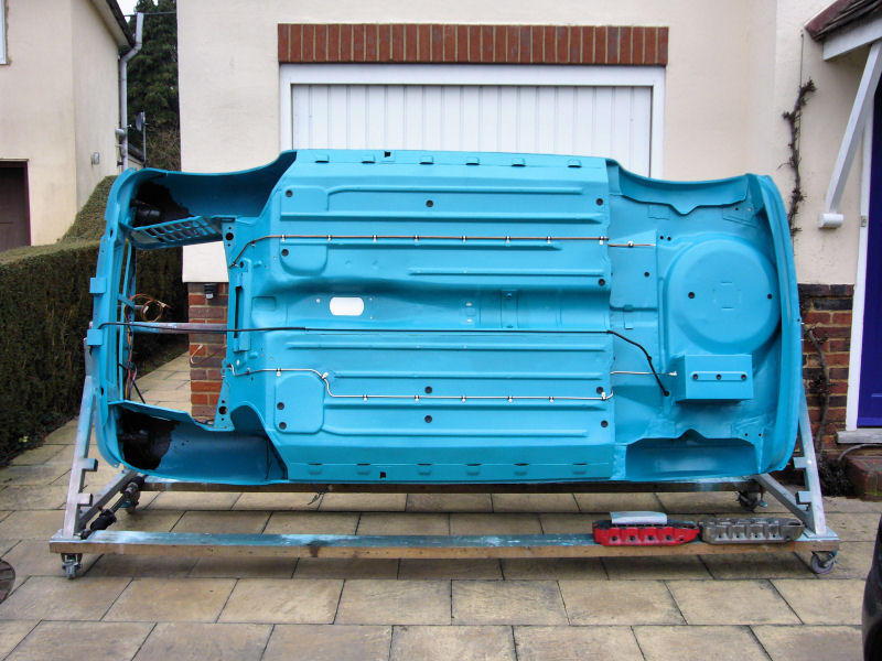

I'm with Mab01uk, stick with the round tunnel.
I had to make the same decision a few years ago with my Mk3 and went for a full floor replacement with the later squared off tunnel. Now I wish I had tried harder in tracking down the original round tunnel replacement.
By the way Mab01uk, fantastic colour choice.
Edited by SolarB, 05 May 2021 - 06:51 AM.
