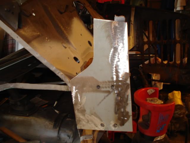

Posted 24 February 2022 - 03:25 PM
I have made my own using 1.2 mm steel sheet.
#9
Posted 24 February 2022 - 10:11 PM
And i made a boo boo with my statement and as Cooperman says it should be 1.2mm. Not 0.9mm as i mentioned. (now adjusted)

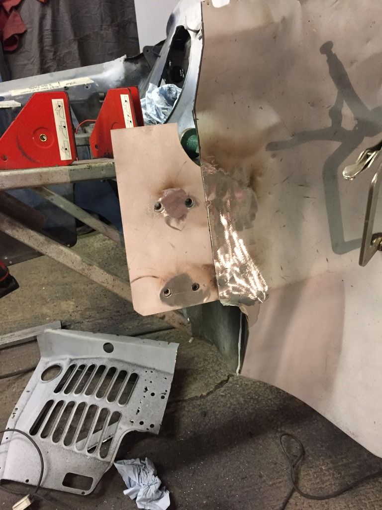

#10
Posted 24 February 2022 - 10:13 PM
Before
After

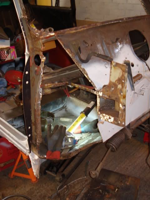

#11
Posted 24 February 2022 - 10:17 PM
And on my clubby
