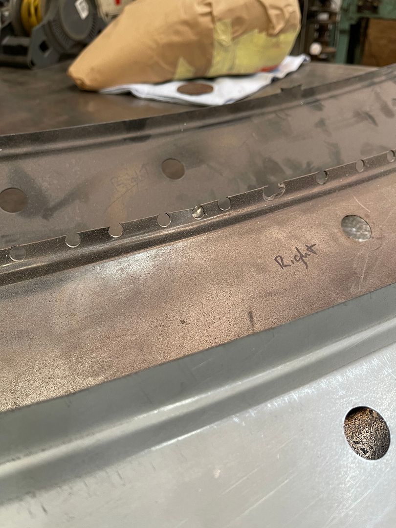

Here’s a shot of Heritage (top), Genuine 1964 (middle) & new Magnum (bottom) scuttles.
CEE0D1AA-F805-4A46-8195-B47B6F65307E.jpe
The steps in the Magnum panel aren’t nearly as well defined as factory or Heritage and the spacing of them is also wrong. Unfortunately I don’t have a picture looking down the length but in places the steps in the Magnum almost just become a smooth concave radius.
As said above note the bullet and buy a Heritage one.
