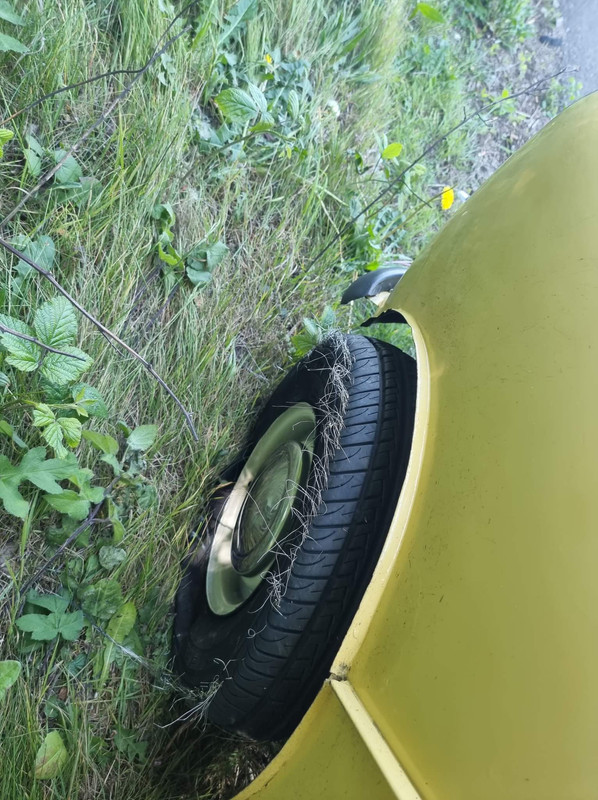

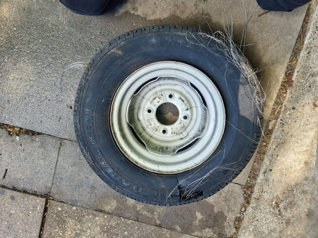

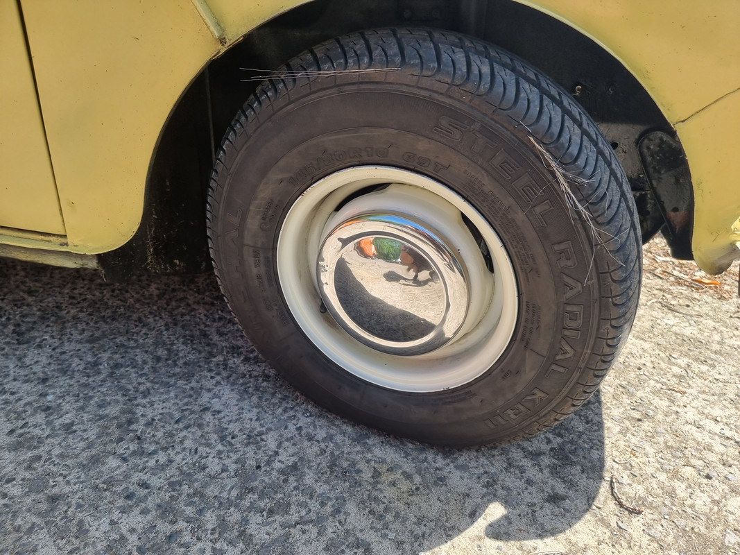

well... the passenger side failed (photo with the grass) as thats where I ended up on the M25.. RAC came and was a mini guy himself so got me his spare from home! We didnt check the drivers side as that was on the live M25 traffic side, but as we drove off I could tell something was still not happy as it was very wobbly at low speed.. luckily the place where I got a couple of used wheels to continue my weekend wasnt far, but when we got there and looked the drivers side had become how you see in the 2nd photo.. still holding air but steel coming out and had lost its structure so was shaped more like a bike tyre.. very odd
Definitely didnt hit anything, or at least nothing significant that I noticed like a pot hole etc.. was quite happily going along at maximum of 60mph as thats where my car is happiest with tempts/noise and it suddenly became like riding an angry shark
