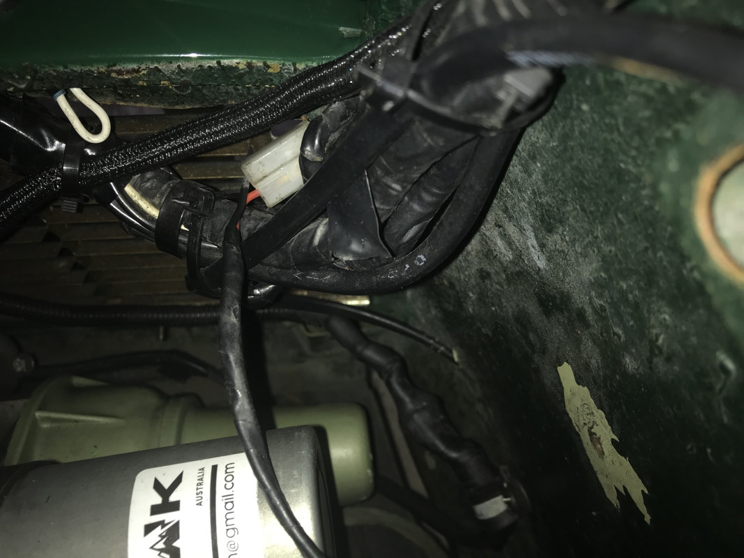

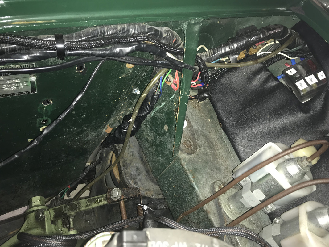

Just some of the mess. You should see behind the speedo!

I’m now thinking I could buy an 850 harness and start with that. It would need modifying as I run the alternator plus a pre-engaged starter motor (still use the floor starter button as trigger), but all that heavy wiring is in place and was done neatly and correctly.  Plus I want to keep relays for headlights, wipers and horn, plus additional fuses (different fuse block though- I’m not a fan of those LED ones), but that mightn’t be so hard to adapt. Or I go with Spider’s suggestion of laying it all out on a board. I watched a YT clip last night of someone doing just that and was pretty impressive.

As an alternative, If the loom is functional, especially the core, could you not just rewrap what you have and integrate all of those add-ons into one for neatness sake ?
Mine had been messed around with a few times and wrapped with horrible electrical tape - unwrapped it all, got all the sticky goo off it, replaced some fried sections added fuel pump to rear harness and rewrapped all in good quality fabric tape - came out a treat.

That’s also another serious option thanks Andosoft. I haven’t had any issues with the wiring, it’s just that’s it’s a mess. So maybe pulling it all out and removing redundant wires, checking and replacing what’s bad and re-terminating everything might not be the easiest or quickest, but certainly the cheapest route.

After thinking more about Andosofts suggestions, I did take a close look today and I’m really pleased I did. After a day’s work I was able to completely remove the second major harness running from the dashboard to the front of the car! I’m not sure why they had run a new harness for indicators, horn, park lights, plus another 2 double cables that went no where other than to the grill (maybe for driving lights that were never installed?). Anyway, I checked the original harness as best I could including voltage drops etc. across all the wires, then re-terminated, checked again, then hooked each component up one by one, checked again and everything worked fine. They had also run a third smaller harness that connected tachometer, ignition, temp sender, but I’m going to leave that one as is.
There’s still a big lump of cables from where the voltage regulator was, but I can live with that once they are bound up neatly.
So a bit more tidying up under the bonnet, then to tackle the speedo head and gauge wiring that’s a massive birds nest of wires. Needless to say I’m pretty happy tonight and can’t thank you all enough for your thoughts and suggestions. If I do need to replace the harness in the future, I’ll have your info to look back on.  :-)
