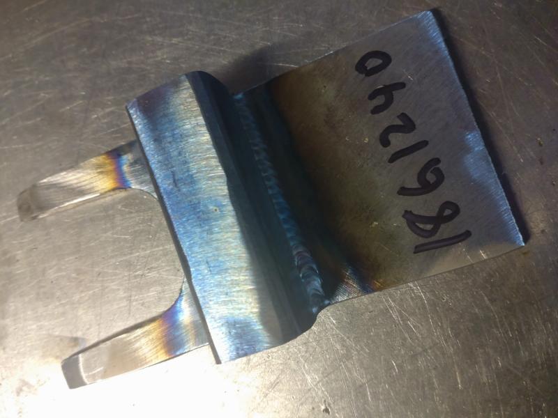

There is not much to be gained by leaving the oil in and if there is an issue you will end up with oil everywhere.
However, the tool to extract the shaft from the pot joint is tool 18g1243.
I actually made one a couple of weeks ago and it worked well (except the numpty who last did the pot joint boots did one side by securing the small end of the boot to the shaft instead of the inner joint thus rendering the tool unusable on that side).
I think they are on ebay. Google 18g1243.
