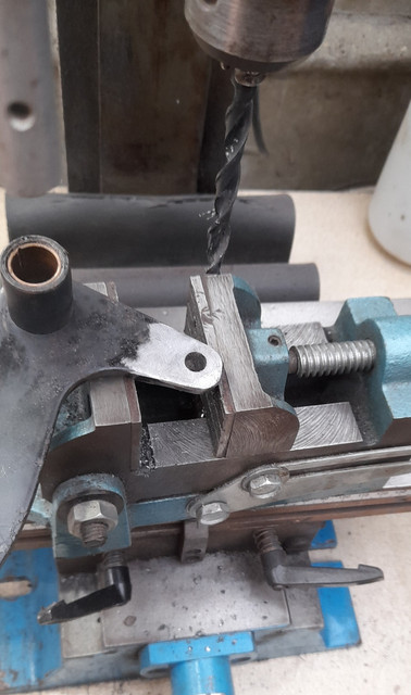

just on that topic of loose clevis pin / cylinder piston slack to pedal
it's not inconceivable that the pin can wear and cause looseness, or in my case (on the clutch pedal but the effect is the same) the actual hole in the pedal widens
I actually had to weld up the hole and redrill for a nice tight fit:
after that of course it did also get a new pin
this is just in case someone reads in future and is looking for sources of extra pedal travel without braking or clutch effect

Nice work Stuart !
