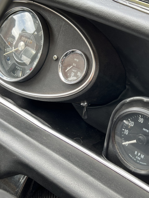

As title says. This little mini has had some switches added and one of them is under the speedo
Why would someone put a switch there? I cant see the wire colours without major surgery. Any ideas?

Instrument dial lights?

Didn't the one-dial binnacle sometimes have a translucent plastic plug with a lamp behind it, and a switch on the side of the binnacle for it? To illuminate the shelf? Did the 3-dial binnacle ever have the same?

lol, I’m thinking that it could be instrument lights, that would make sense. I will test tonight in the dark. Not driven it at night yet!

Ignition kill switch?
Feel around under the other side, is there a wee lamp cover there?

So the switch isnt for the bulb for the gauges. I was in a tunnel yesterday and the switch didnt seem to change anything!

It’s normally a factory switch to turn off the instrument lights (when the headlights are switched on). I’m yet to find myself in a situation where I want the instrument lights off at night!
On the other side of the single gauge pods there was also a switch to turn on the parcel shelf lights.
I thought it was to turn of the instrument lights when the sidelights were on for parking purposes.  Many many years ago at least some cities insisted on marker lights for cars left parked on the road; Southampton was one.  A little light that clipped onto the window was sold as an alternative to the sidelights for the job.  Obviously the instrument lights wouldn't be needed for a parked car.

I wire the electric petrol pump from that switch.
There is enough fuel in the carb for the engine to start and the thief to get about 200 yard.
I worked on the principal that it is very embarrassing to have to get out and be seen pushing the car to the side of the road to let the following cars pass, and wish you were in some other car.
At least, that's the way I used to feel, when I forgot to switch the pump back on.
