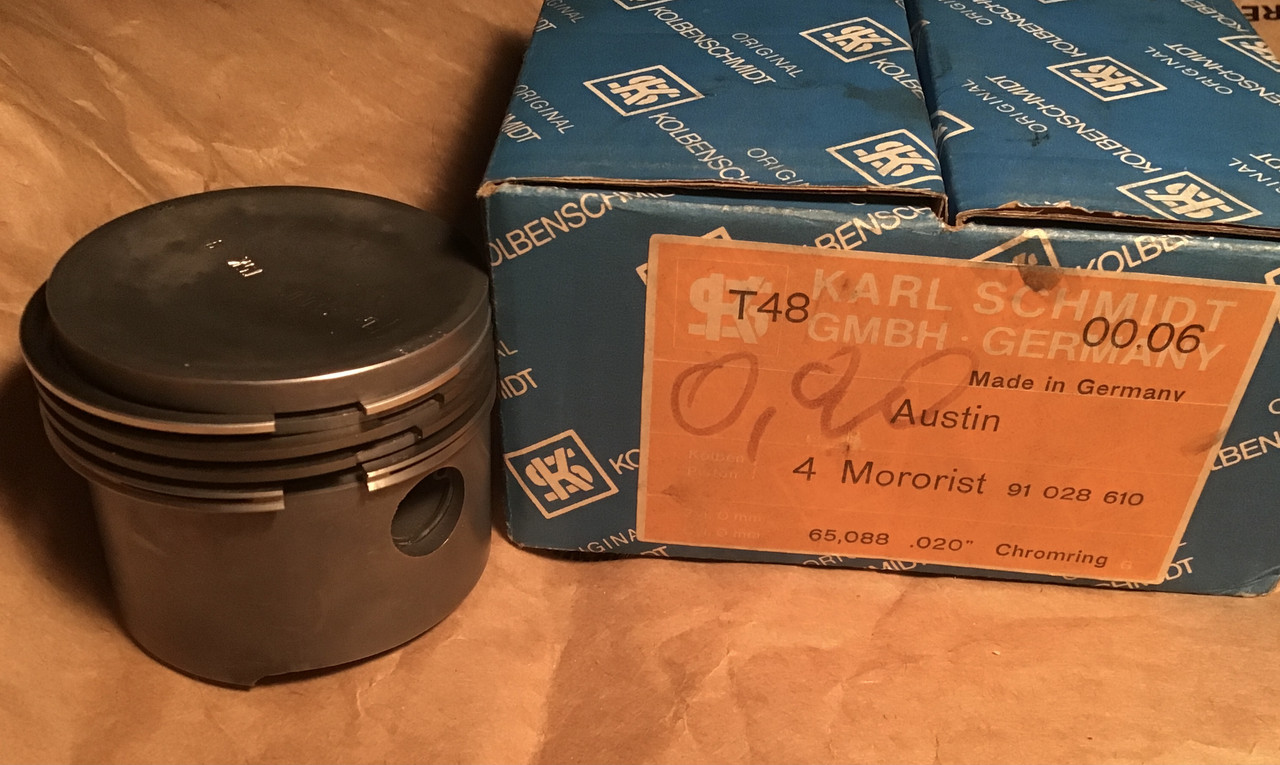

Doing a rebuild on my 998, it was time, got a good 1098 crank (is cross drilled as well) and nos Karl Schmidt/Kolbenschmidt  1100 .20 over pistons (had a 1100 motor in my first car, really liked the torque curve). It is also getting a fresh metro grind cam and lifters. Gearbox is being gone through as well, was pretty good, upgrading to a cross pin diff. Have a rebuilt 998 head on it from a few years back (got rid of Canadian smog head)
Was wondering if anyone has done this and has any info on how much one could deck it safely? I might just clean up the top of the block. Also is .0025 piston to wall clearance a good number for these?

One other thing I've noticed is that these pistons have four rings, is it two compression and two oil rings? Also noticed the top of the piston says "Sp 0.03" "15k" "65,088"
I doubt that your pistons have 2 oil rings.  The oil ring's groove is always at least twice as wide as the compression grooves.
It probably doesn't make any difference, but I arrange the gap in the rings alternately 180 degrees from each other, to make any escaping gas have to travel further.
My grandfather's Lanchester had recessed pins in the grooves that located the back of the ring gap so that the rings were arranged in this manner and could not rotate, and for many years I had assumed that this was just Frederick Lanchester's attention to detail, but it was probably something to do with the sleeve valves.
He wouldn't be the first person to see the parts that make up the oil control ring and notice that it's two rings and an expander.

Karl schmidt used to make a lot of 4 ring pistons back in the day, the same as other companies, ring pack technology has come on a long way since then. Very good pistons all the same, and still available ( not for A series though as far as I know).
Shooter
They are NOS pistons

I have Karl Schmidt 4-ring pistons in my 1310 'S'. They are super and take very high revs with no issues. I run my rally engine at 11:1 CR with a 286 cam and it's very competitive in its historic class.

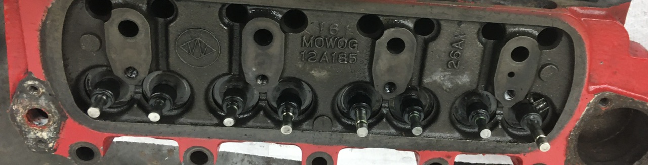

How about a 12A185 head?
Can't find too much info on it other than they came on 948cc spridgets and possibly 997 coopers?
its the 9 stud one. The intakes look a little more square on it, I can port the exhausts a bit bigger on it. Metro camshaft going in it
Thats what I had on it, going to have to put some guides and maybe some new seats, it came with a  ECAM 4004(?) originally which was the standard Canadian smog head, no real info on that anywhere. Assuming its not great, it had the ports for the air pump.
I decked it 5 thou as when I dry assembled it #1 was 9 thou but #4 was about 17-18, measure the block and its square so I guess rods+crank variance, is that going to be alright? Putting a balancer pulley on it too.
