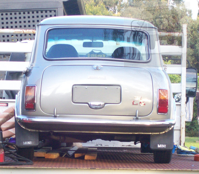

Would it be similar to an Australian Mini Boot Lid ?
I can measure one later when in the workshop.
Thanks for the offer, enne reply was spot on, I think innocentis are different to Aussie ones.
