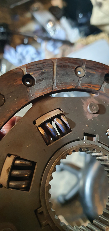

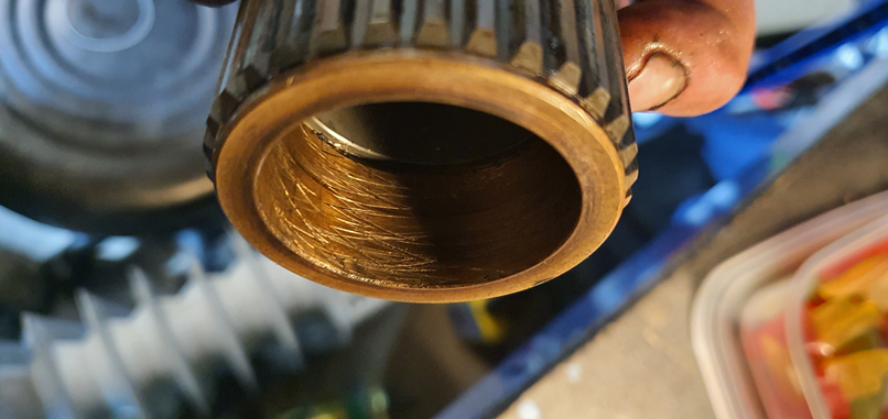

#6 secretpanda
secretpanda
  • 12 posts
  • Location: Doncaster
Posted 11 March 2025 - 06:12 PM
It does sound clutch related to me,
The 'litmus' test for clutch operation is selecting reverse. When warmed up and stationary, if you can depress the clutch and select reverse without it grinding in, it may give a small noise, but not be a dragged out grinding then the clutch is working.
trying to get reverse is also very crunchy, the clutch has some odd wear on the springs, like they have been rubbing againt something? also the bushing on the promary gear looks real bad! it was spinning ok on the crank tail but not easy to remove! see the pics, ive ordered new clutch and drop gear set. hopefully it will solve the issues, luckily the crank tail is fine and no scratches or marks
