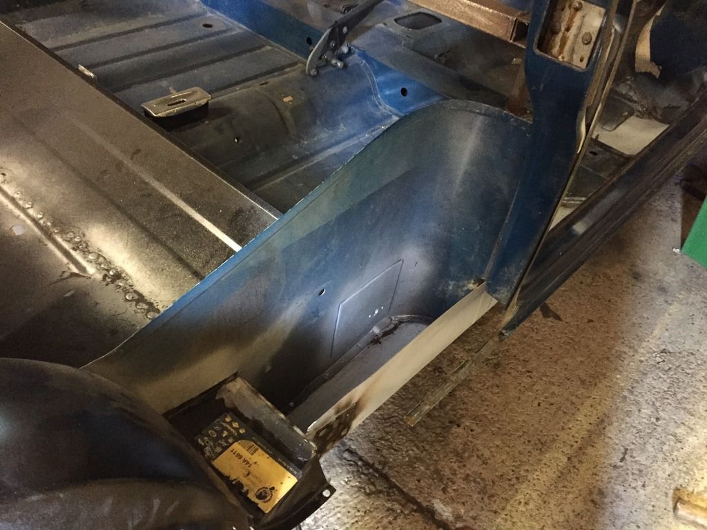

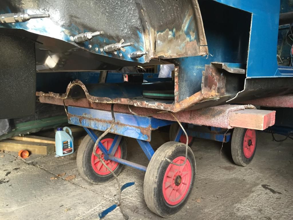

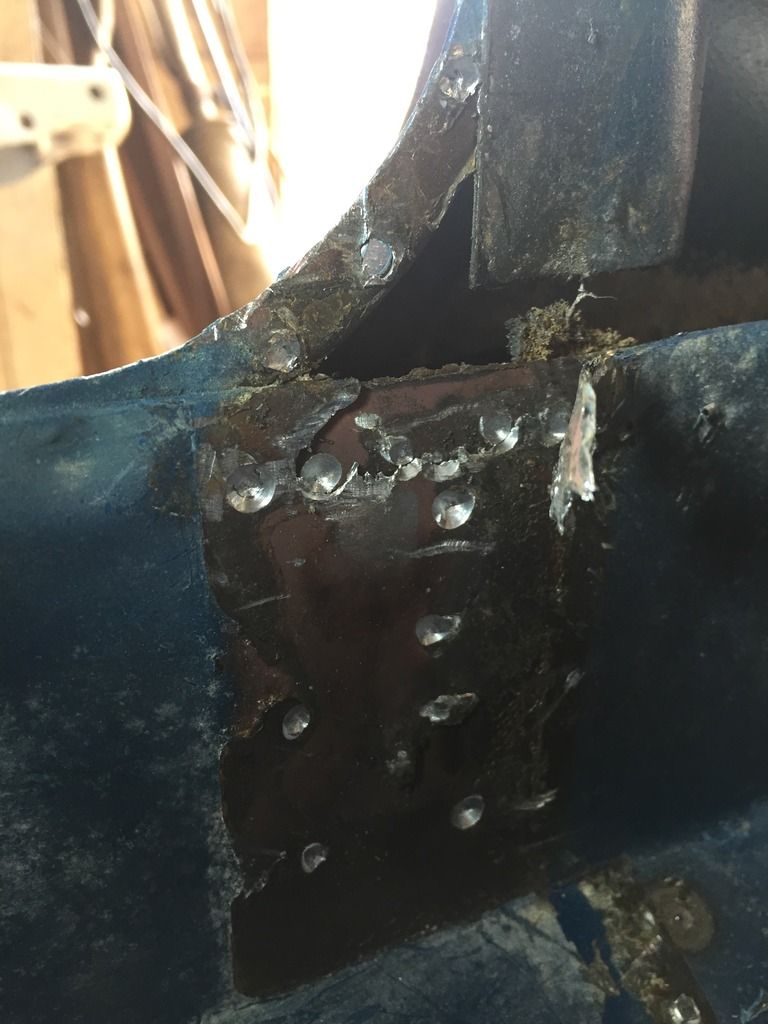

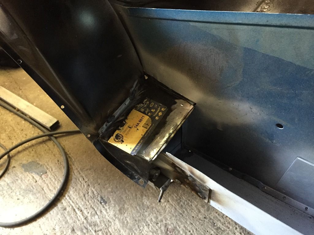

Posted 10 July 2025 - 01:41 PM

#4 Davemoorejagman

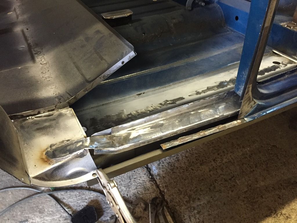

Neil, based on the last picture in your series the stiffener goes in like this.
I read somewhere that it is has a twist in it - which mine  have will in order to meet the top of the inner sill where it meets the B pillar.
I am putting in a whole floor.  Wondering should I tack all this in place and fit the floor or fit the floor then put these in after.   Feels like it possible to slip the stiffener through the companion in, particularly if the closing panel is not in yet.

#6 sonikk4
sonikk4
    Twisted Paint Polisher!!!
  • 16,079 posts
  • Name: Neil
  • Location: Oxfordshire
Posted 10 July 2025 - 06:22 PM
The stiffener does tuck in under the B Pillar, so if you are fitting a full floor you can leave the stiffener out and the comapnion bin as you need to get to this area
