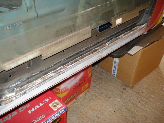

Although this was from a long time ago on my lads car this is what i did to one of his doors. It was really bad and with the skin off makes life easier. BUT be careful to make sure the slit is big enough to take the worst of the curve out but still leave a small gap to allow you to weld without puckering the metal.
