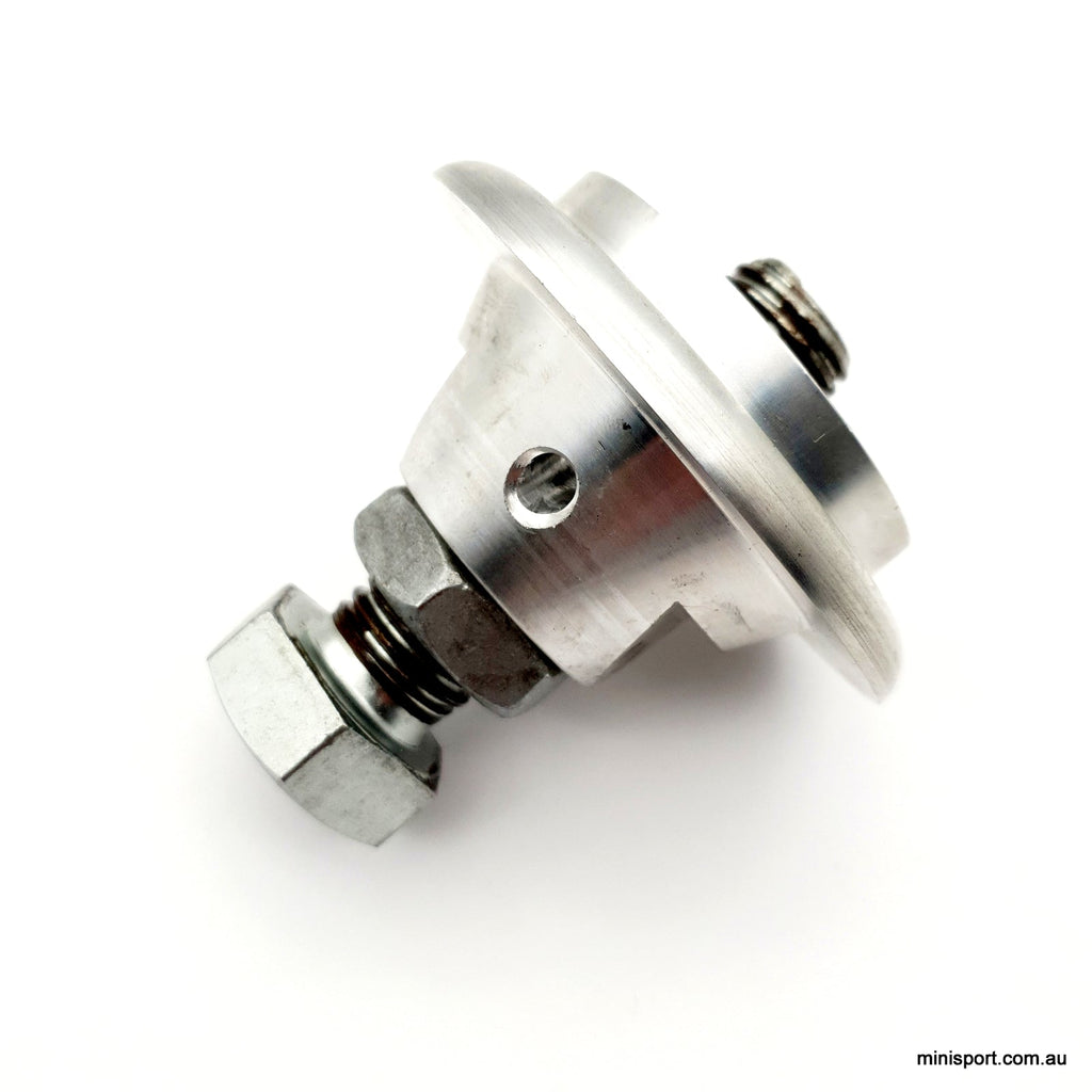

I reckon fitting the larger diameter flat platform hilos has a big effect on how a spring performs too. There seems to be only one option for one with a shape like the original ones. https://minisport.co...=44572152299830
3907_1024x1024.jpg?v=1677150566
Most of the mini businesses here in Australia get their own ones made up with the rounded profile. I haven't seen any of the UK suppliers doing the same.
