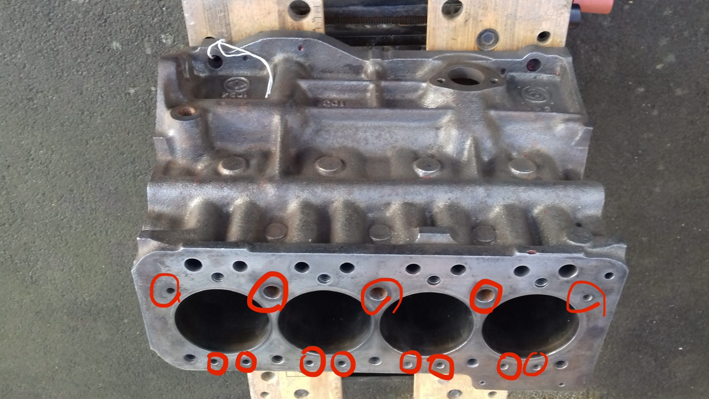

When looking down on a 1275 block, which holes are coolant holes?
I’ve been having issues with coolant getting in the oil quite quickly. Had the head crack tested and skimmed but still got an issue. I removed the engine from the car to block and seal the two redundant oil pump bolt holes, and whilst it’s out I thought I’d check the gearbox wasnt filling from the rad. I poured boiling water in the rad until it appeared at the face of the block. I was quite surprised it appears at all holes except for 2. I always thought the water was just in the 3 larger holes between each of the bores, but it’s in all 8 along the front between head studs too. Always thought the small holes were oil ways.
No water appeared in the gearbox so I guess the block is good but would like confirmation of the water ways if anyone knows.

These are coolant holes. The head gasket might have some more holes that don’t match the block
The oil feed is top right. Oil drains down the pushrod holes
Perfect, thanks Timmy850. That’s exactly where the water showed up and answers my question.
