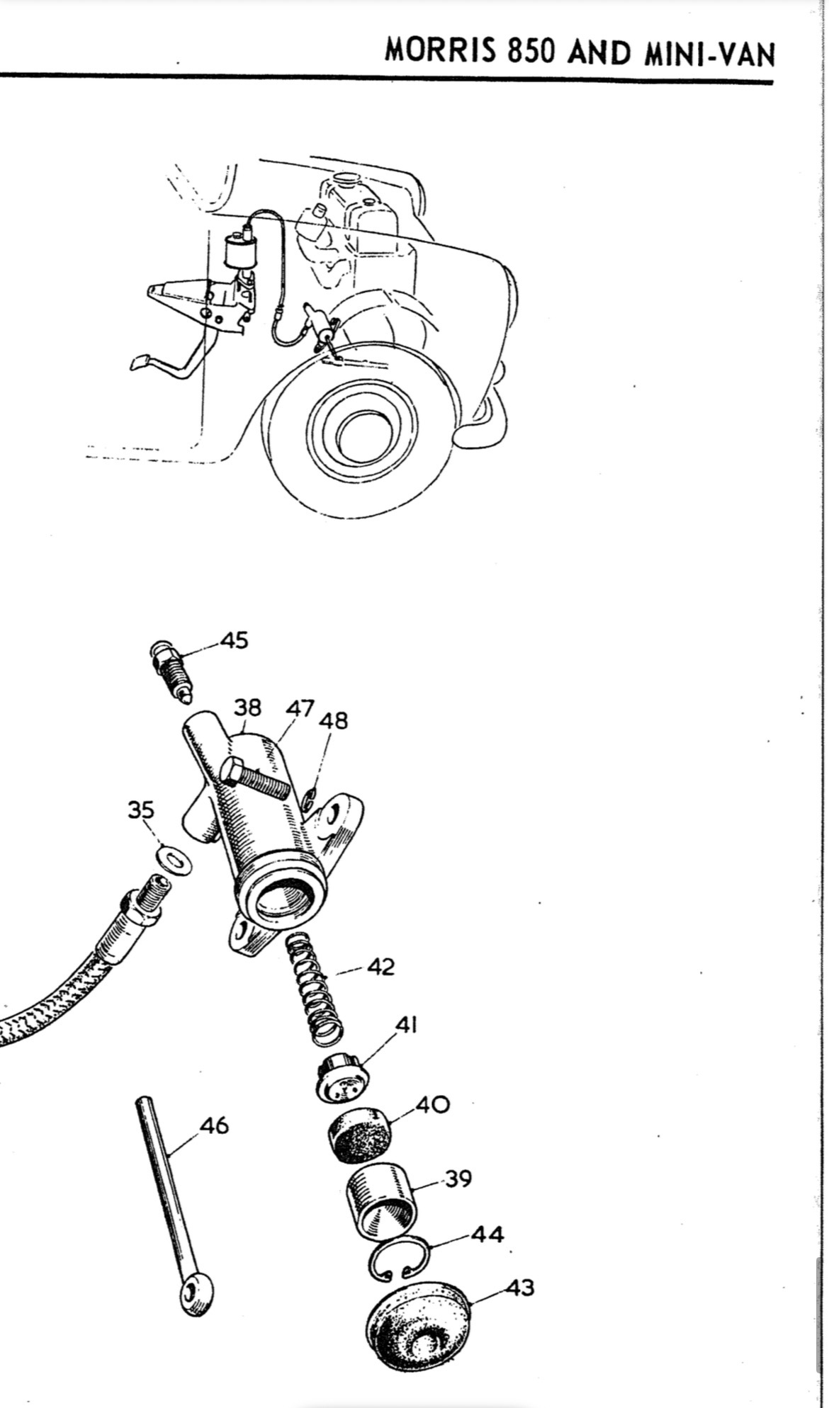

They had introduced the circlip before this manual which was 1964
Yes, it was there from day 1. The Slave was unchanged up to the introduction of the Verto.
