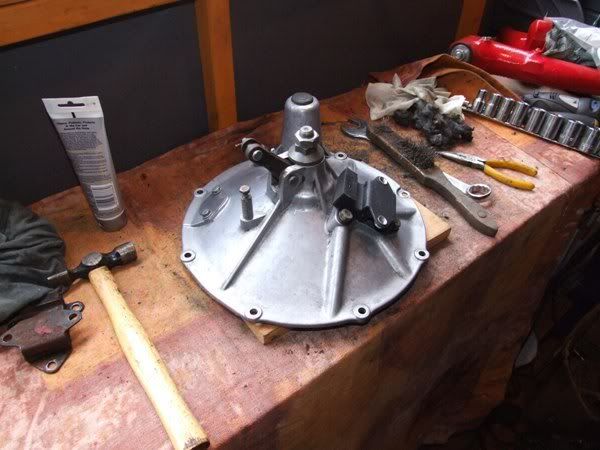

Its not too bad I suppose, just another bit to weld back in. To put it into prospective I am more narked I can't find a CD that I know I have in my collection somewhere.
Easy day:
Dismantled, cleaned and rebuilt clutch cover. . .not taxing nor exciting but another "warm" job crossed off the list.
