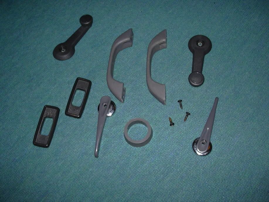

elfred this is the furniture set that came off my car when I replaced it with chrome
But, to be honest I had never noticed that the window winders or the lock surrounds were darker, they look the same shade once fitted
